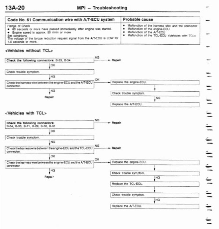

Copied this from engine workshop manual......
You can look up connection numbers in the electrical manual

Cheers phil,
Yea almost as soon as i wrote this post i thought hey maybe its in the manual of exactly what to expect to do.
Matt has his workshop manuals printed out here in binders too - was just curious if this was a problem seen before or not and the best way to tackle it.
The TCL light as i said came on as well - so im thinking it may be a TCL ECU malfunction (the harness and the ECU seem fine from initial inspection doesnt look like its a cable fault) Would this throw it into limp mode?
Does anyone have a TCL ECU i could borrow for an hour to check if that is the problem?

Think code 61 relates more to your TCU being stuffed.
