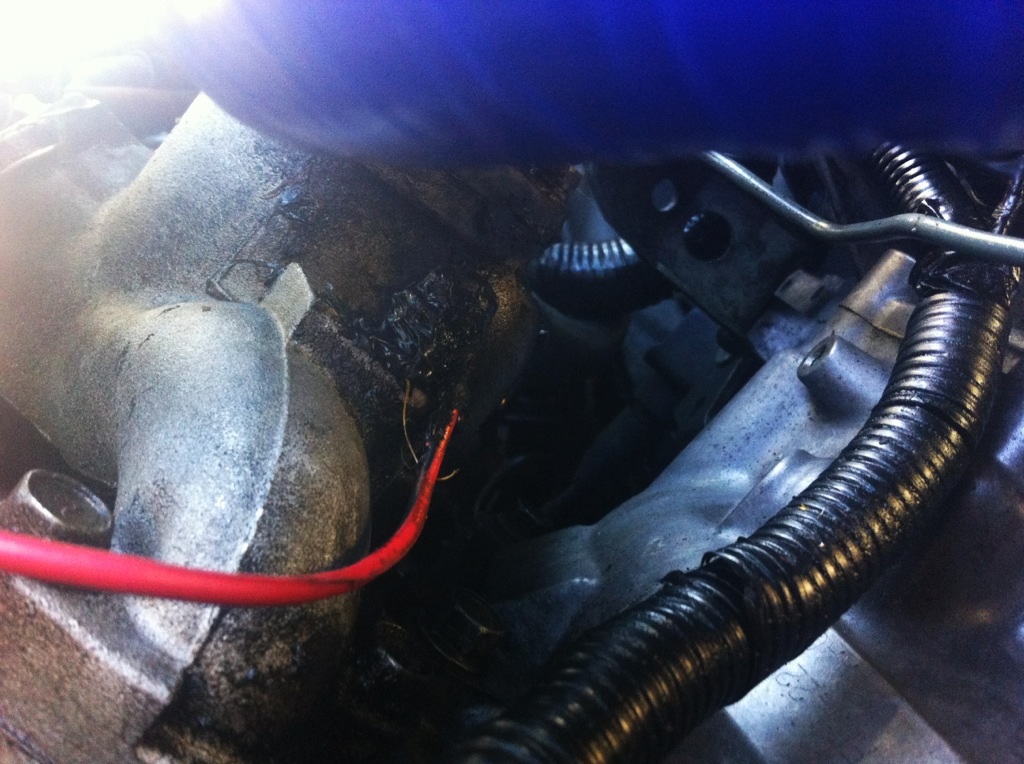

Need the small sensor that screws in under neath where the radiator hoses go.Think it's the coolant sensor yeah? Which is attached to the gauge in the cluster?

Coolant temp sensor is the one that goes under your coolant tower near the thermostat. It's basically in the gap between your intake pipe and engine.

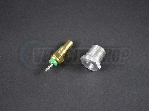

Buy one off Shhtuart mate he has like 50 left - http://ftoaustralia.com/v3/viewtopic.php?f=2&t=28252

The sensor i sent you is the ECU one. The dash sensor is different.

Hard to get a pic.. Mines dodgy as f**k.. And faulty so not much help.. It basically looks the same as that last pic..
Don't no where to get one? If the one that Stuart gave us is called the coolant sensor wats this one called?
When u take it out, u lose a sh*t load of coolant, sooo......
(Mines covered in sealant because the threaded is abit rooted and I didn't want it to leak)

Re: Temp sensor
MD091056
That's the dash temp sensor. A few manufacturers share that part so you might pick it up on ebay cheap.
