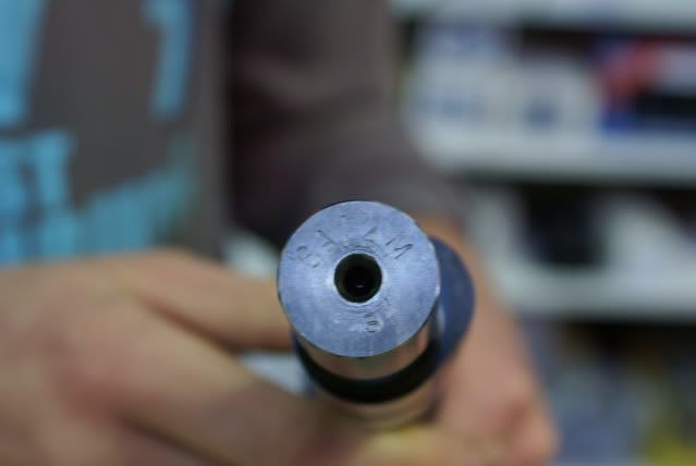

Does anyone know if the stock cams write 6a12M
on the end of them as in the picture below with a 's' on the other side??
sorry about the big picture but its the only way in being able to see it clearly...
and also billet camshafts dont usually have the middle bits painted black like this... can anyone else confirm this?
and also it looks as thoo they are used... the black paint in between is a bit worn in places... and myy mechanic said that one end looked like it had a pulley attached to it(as in used)

but surely when someone has taken their cams out they might looked to see if they say 6a12m on the end of them or not?
would dstocks know? could it be the part number proving it is a original cam not a billet?
thats the main issue im worried about cos its a difference of paying $2200 to paying $1400
so a bit of a difference in price!!!
Sorry, never touched my FTO engine, don't trust myself. :roll: :D
mate, it looks new...
if you crack open your cam heads youll see the used cams will have a yellow/black tinge to them because of oil staining...
as for the 'scuff' marks.... its got to be when they've tested them to see if they are balanced...
i wouldnt worry, in any case, they will work.
the 6A12 is the engine type and 'M' is for the fact they are MIVEC...
i wouldnt worry about the 'S' it could mean anything... most likely 'stock', as in, the same as an OEM cam

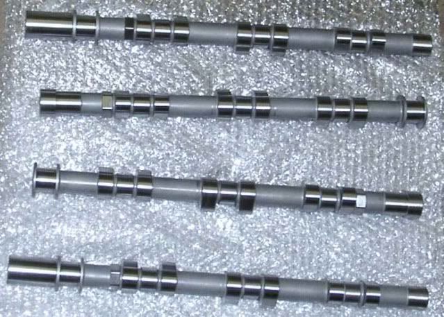

should my cams not look fresh and new like these?
the pic is off the RPW website and if mine were like this i would be happy but it is very unusual for billet camshaft grinders to paint the bits in between in black...

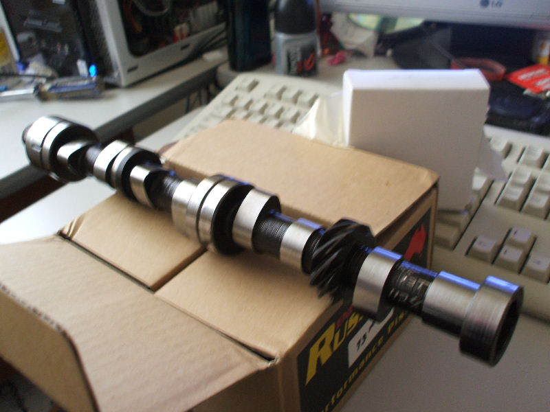

that looks to me like almost certainly a reground cam, if it is a billet cam, why would they stamp it on the end with what seems to be a factory code?
here is a pic of a cam i had reground, its not an FTO cam but yea.

Posts: 23677
Good lord, thats a mini cam! I recognise that dizzy drive half way down the stick anywhere :)
EDIT: Judging by your user name it is :lol:

does the number printed on the end not mean anything?
i know uve taken a few engines apart bennoz so is that number on a stock cam?

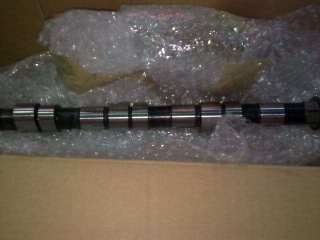

sorry to add to the speculation, but this is the pic that bothers me.
It just looks rather used...
