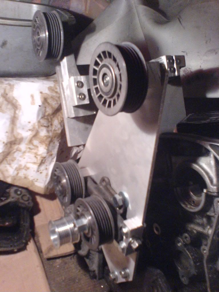

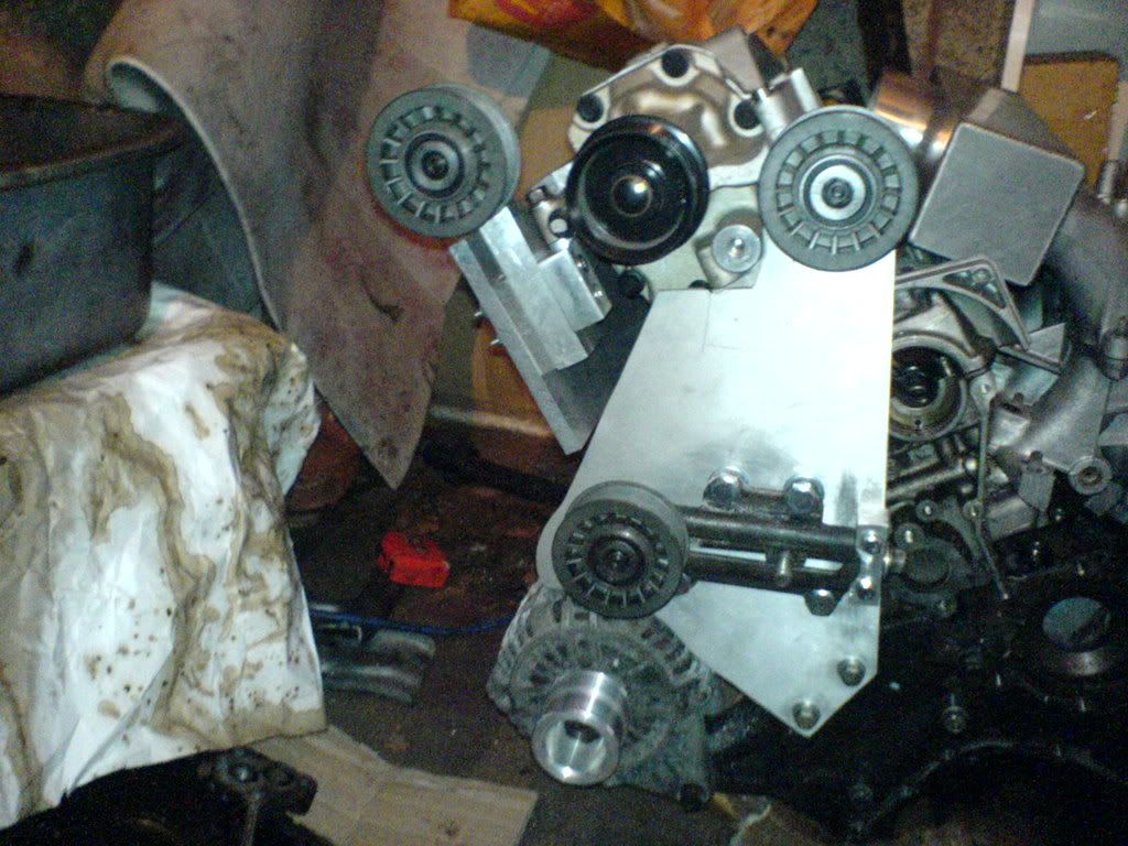

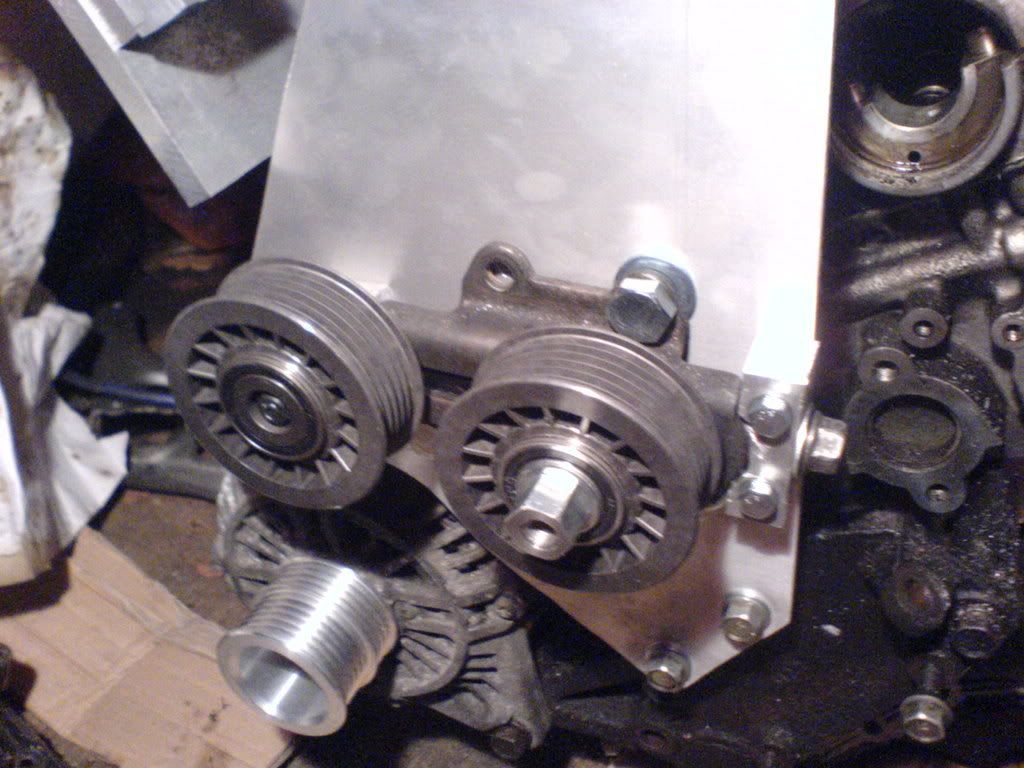

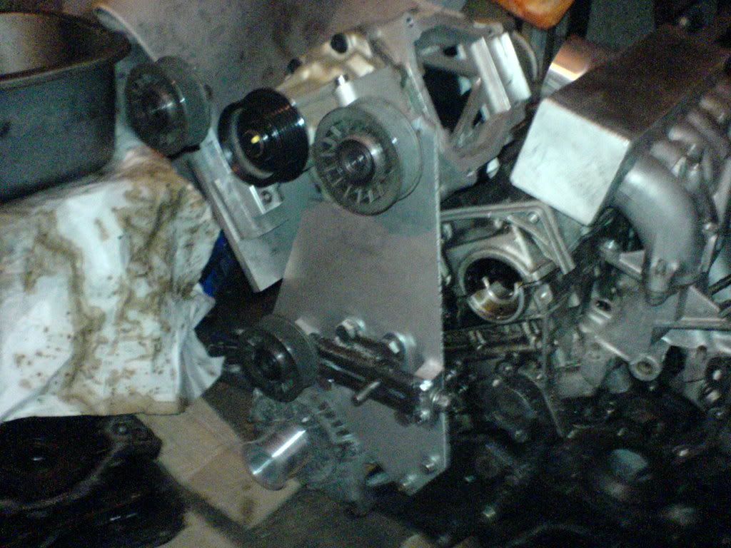

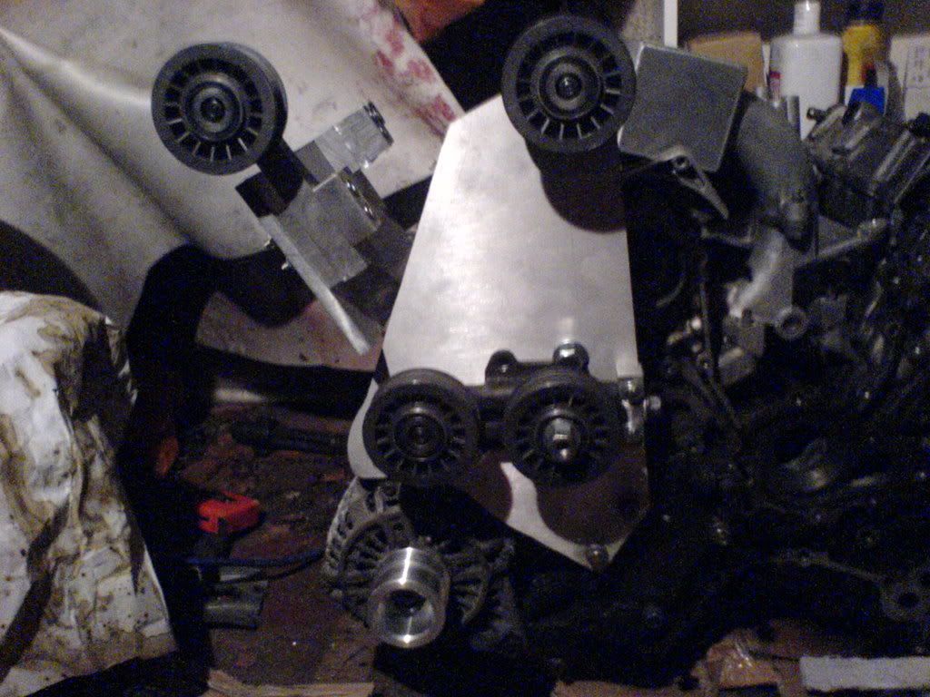

This is Robs:
I came to the conclusion that the Vortech system that the Yanks sell as a kit for the Eclipse would have been the easiest install. Shame the Vortech blowers are 3 grand off the shelf.
This is Robs:

@ Bennoz- In the pictures it looks like the alternator has had a second pulley added. Could this be done to the 2 existing pulleys on the crank? I read in your thread that you were planning on welding another on then getting them rebalanced. Where would I go to get this done? Engineering workshop?
