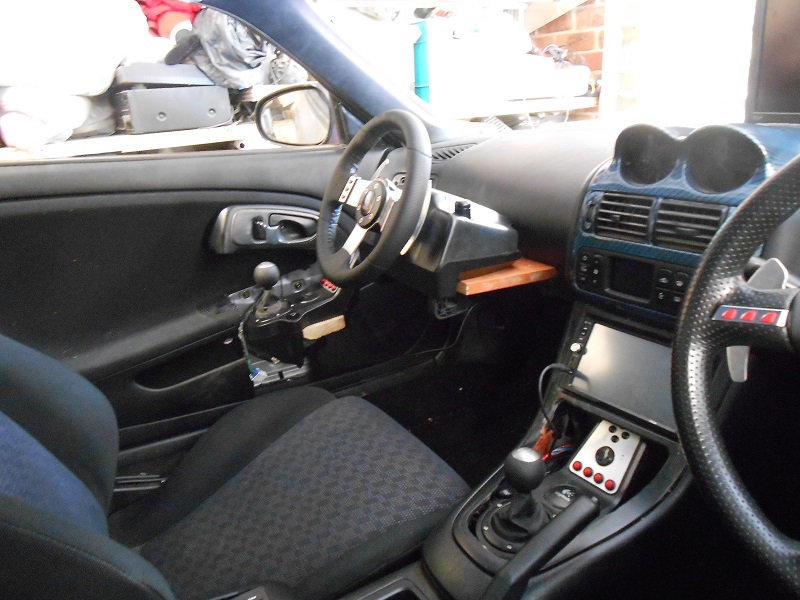

    Image on screen look a lot better in reality. For some reason looks washed out. Anyway, a couple of pics:
    And a very short video. Not sure clicking on it will work.Right click download instead.

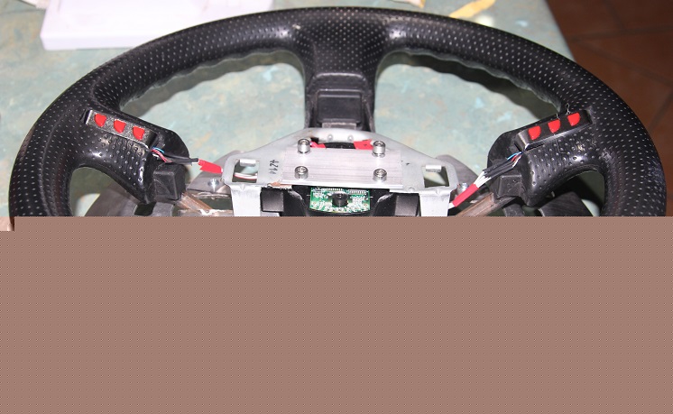

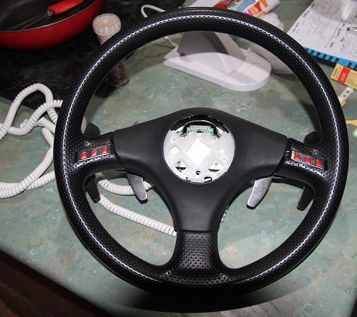

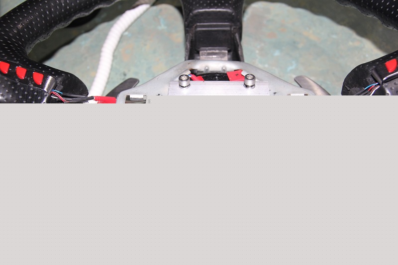

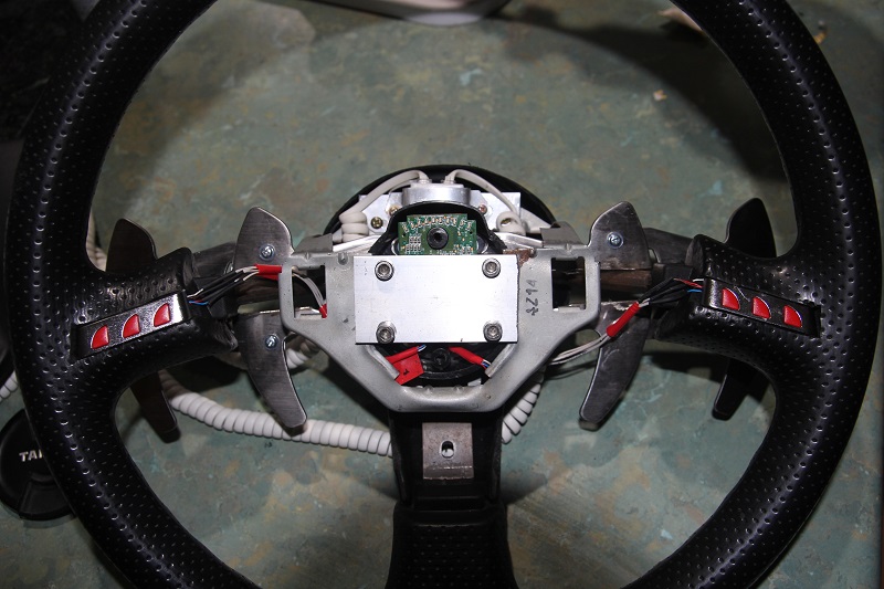

          So, have been working on the steering wheel. Have relocated all buttons and tip shifters to the wheel. Have had to extend all the wiring and the circuit board is now inthe FTO wheel. I just have to do the front face now. And now, some pics.

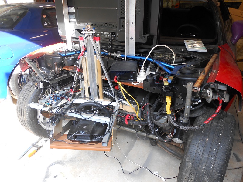

            Have also built a new mechanism for the actuators. I now have the ability to change where the actuators cut in and have much better fine control.

                OK, finally got the buttons on the FTO wheel and tip shifters working. These were transferred from the logitech wheel.

                    Pic of the new actuator setup on the front of the car:

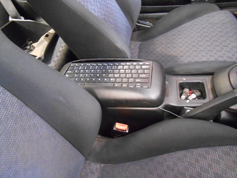

                    Keyboard in centre console:

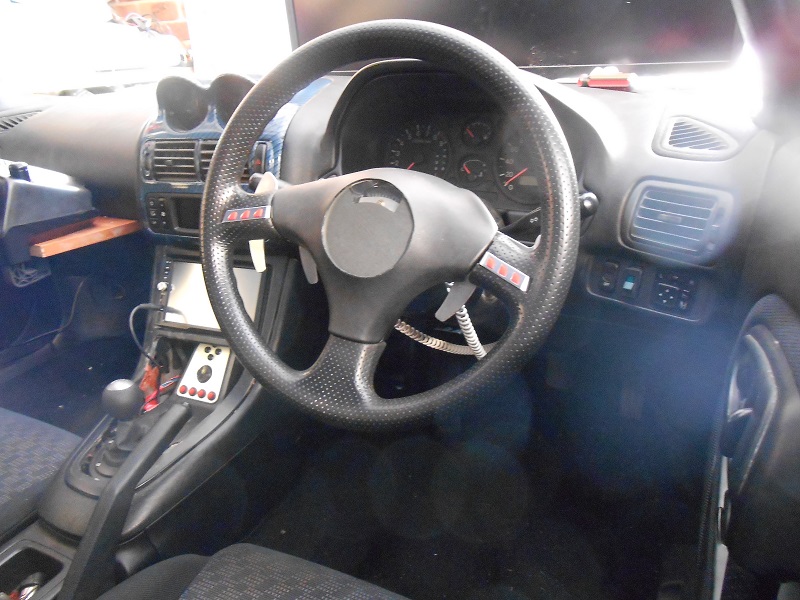

                    Here is the steering wheel now, complete with tip shifters, working buttons and shift lights in the centre:
