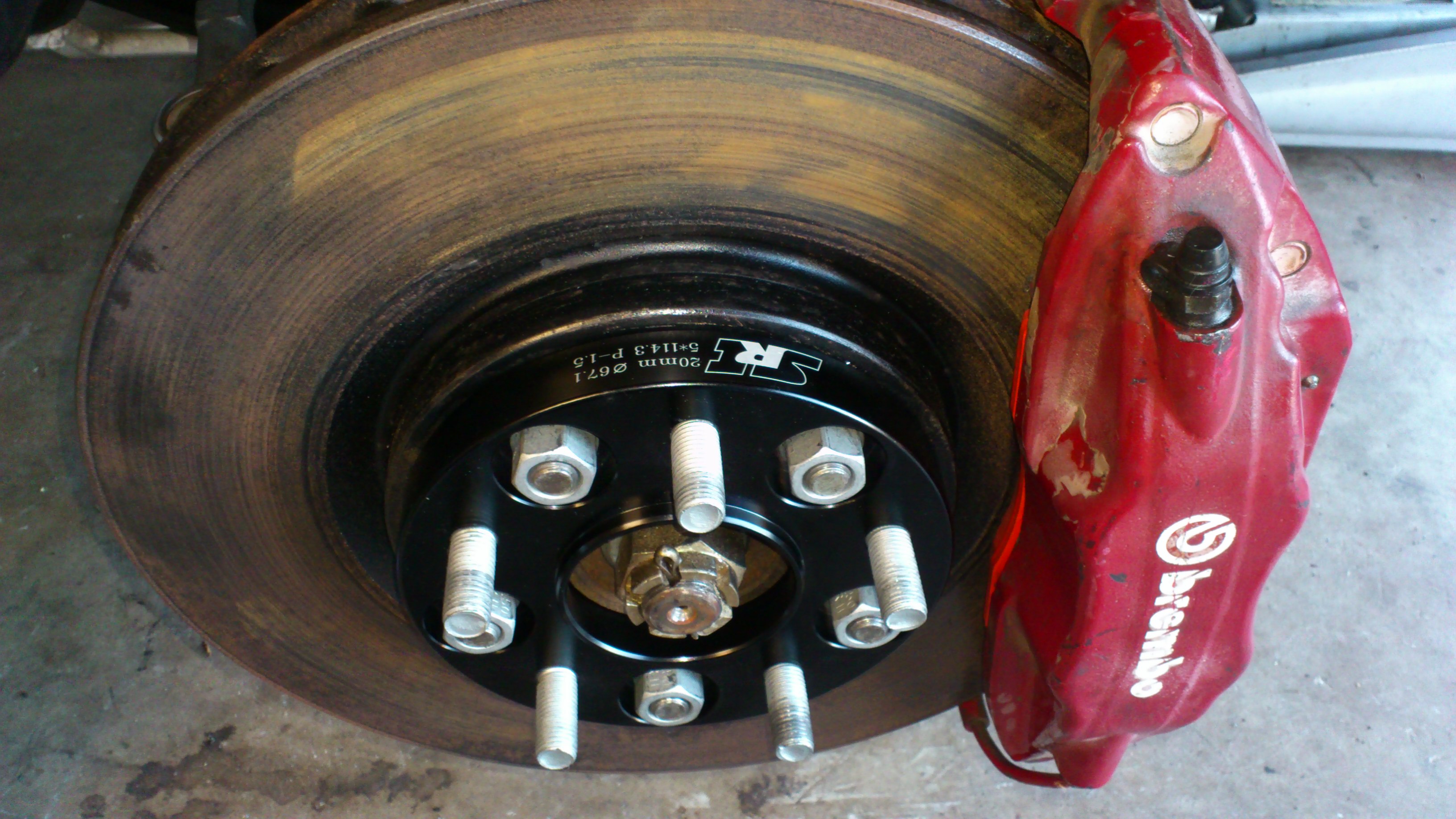

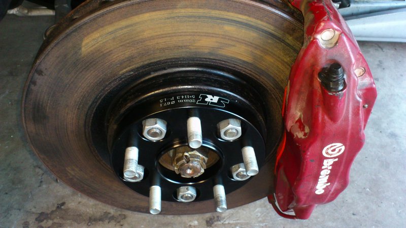

I've actually grabbed a 20mm set to test with today :lol:
I'm hoping that the angle of the assembly all dropped down (car is on stands) is causing the 'look' of being too wide (ie looking down from above & seeing how far the tyres sticks out)
So I'll pop these on & drop the car back on the ground. See if we can squeeze them under :)
At least then, I'll be able to measure the offset I need.
Posts: 23676
Re: Big brake kit
Fits :cheers:

All fits just fine with a 20mm spacer! :cheers:
Before dropping it down:
Stance 8)
