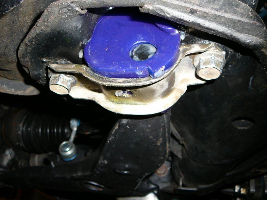

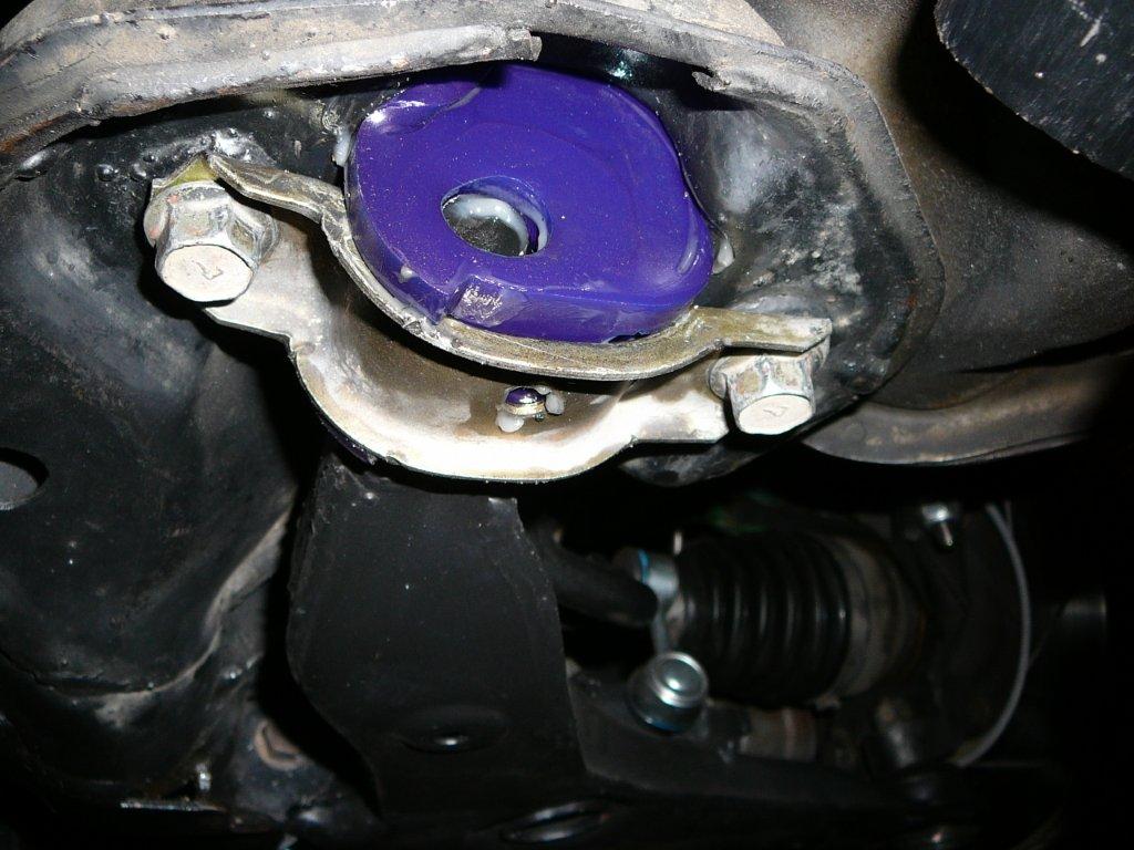

Re: The Suspension Thread
What's wrong with these pics :evil:
Holy f**k they twisted a bit!!!
Bushes the wrong way round :|
Going for positive camber were we?
What's the positive castor bushes part no again?
Bennoz wrote:Bushes the wrong way round :|
Nope, they both turned first session on track at bathurst :(
Had to run the whole weekend with them like this :evil:
Brand new bushes as I noticed at WP a few weeks back the wheel alignment was suddenly out on the front, and the right hand bush (2 years old) had turned. When I pulled em out to swap them for the new ones I noticed the nipple on the left hand bush was about to fail also. Anyway long story short, they're being replaced by non offset poly bushes this weekend.
