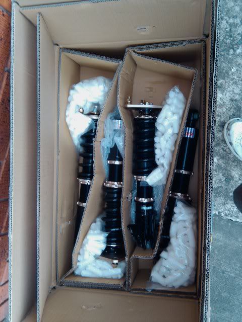

I did a search, didn't really put out desired results...
I'm currently running KYB AGX struts and whiteline, maybe lovells SL springs... but, just not cutting it for me.
Now I know I can get inverted coilovers for the FTO, which are practically a direct bolt up to the lancers (we lancer owners find out a lot in the sense of what can bolt up
But that main question is, does anyone run the BC inverted's, are they decent? any better noticeable performance on the street/track? Worth the extra dough?

I have the BC racing gold BR series I love them sometimes though bit harsh when on sh*tty roads but other wise awesome

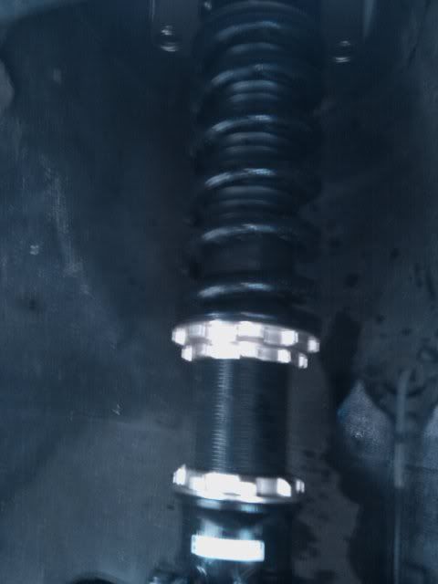

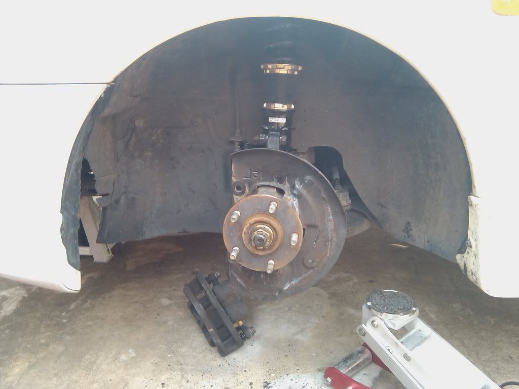

Man I'm full of help for you today Skip. I am running the inverted RMs - 8kg front 6kg rear. I am more than happy with them. If it was a daily driver I would have gone 7/5, but as you know I don't drive the mirage a whole lot. For street use, you won't notice a whole lot of difference from the BRs, but the inverted damper is designed to give you benefits on the track. This is straight from the BC website on what the advantages are:skippy wrote:I did a search, didn't really put out desired results...
Now I know I can get inverted coilovers for the FTO, which are practically a direct bolt up to the lancers (we lancer owners find out a lot in the sense of what can bolt up)
And in all their glory:Unsprung weight is reduced by moving the oil and gas reservoir way from the hub and attaching it to the shell. Unsprung weight is vital to a cars performance as a lighter wheel and hub assembly which readily moves in response to road bumps will have more grip when tracking over an imperfect road.
- fraz91
- Hair-do
- Posts: 881
Re: The Suspension Thread
I don't understand how that's an inverted shock. From the photos, it looks like just a standard twin-tube strut with an screw-adjustable coil seat attached to the body of the outer tube. Or am I missing something here?...
- Shane001
- Posts: 2730
Was wondering that myself, an inverted shock has the body attached to the car and only the piston rod attached to the suspension/hub.fraz91 wrote:I don't understand how that's an inverted shock. From the photos, it looks like just a standard twin-tube strut with an screw-adjustable coil seat attached to the body of the outer tube. Or am I missing something here?...
