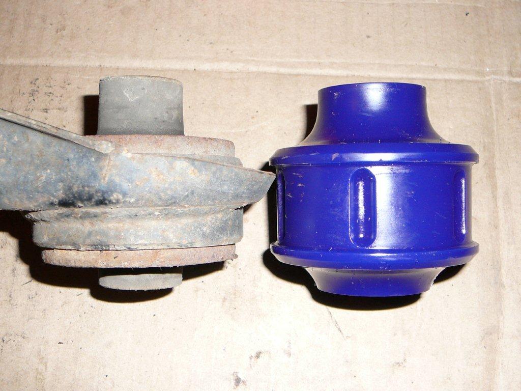

OK my rear trailing arms are now out, from the pic below it now makes sense how this bush installs.
Now I just have to get the old bushes out. Ben, any chance I can drop by and use your press tomorrow :D

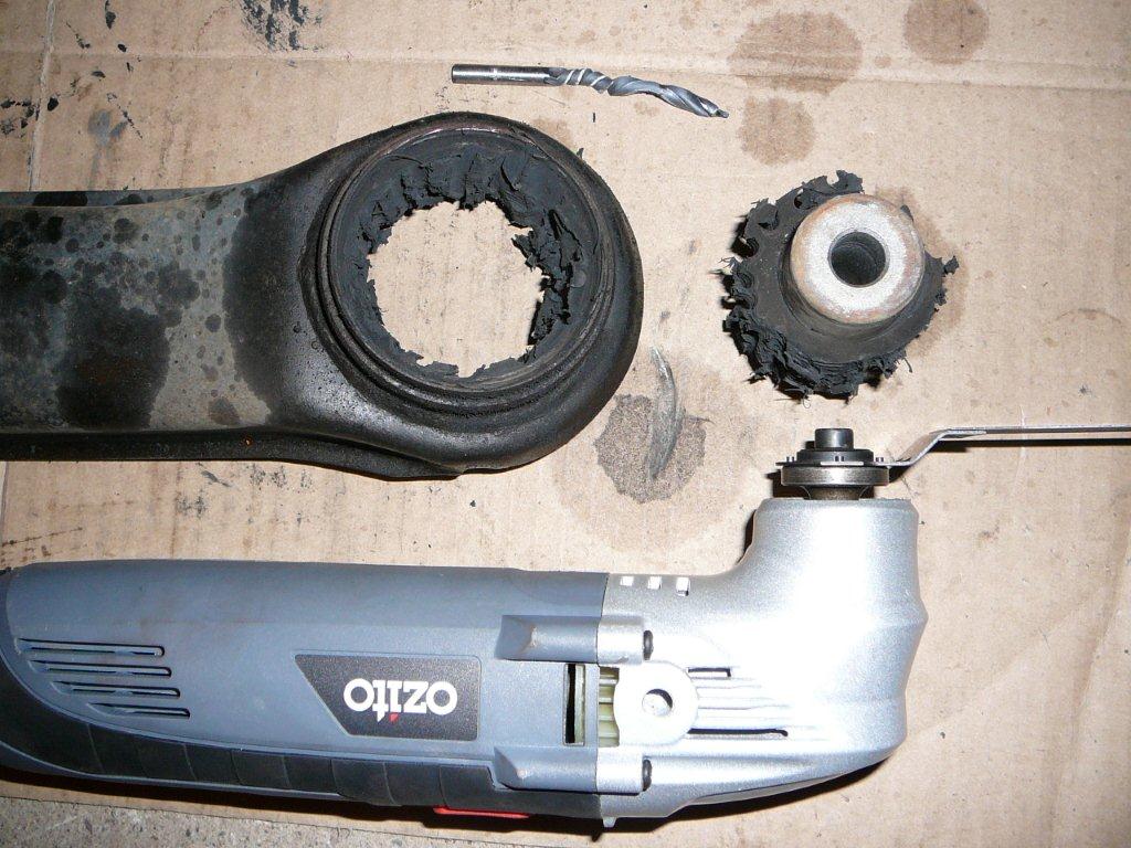

OK, had a chat with Ben yesterday and a bit more of a think about this, and decided to go to town on the bush with my cordless drill :lol:
I used a 6mm drill bit and drilled holes all around the outside of the rubber bush as close as possible together, then drilled at an angle to cut out as much of the rest, then finished off with the multi tool in the pic until the centre fell out. That's the easy bit out of the way!
Edit: The bent drill was a 4mm, a bit thin for this tough old rubber bush :lol:

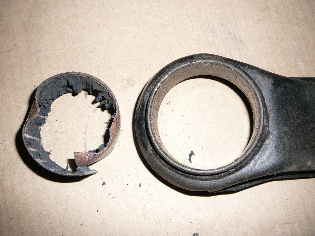

Now to get the metal outer casing out. I did as Ben suggested and got a hacksaw to the casing from the inside, being careful not to cut too far as I didn't want to score the housing itself. Once this was cut through I got the hammer out and bent it down, then hammered a screwdriver in between the casing and the housing to separate them.
Now to do the other one. Then I just need to give them a good clean up and start putting it all back together :D

Yep, and potentially this is better for the housing as well, as you're not scraping the bush casing on the housing as you press it out.
Interesting the casing did seem to have 'fused' a little to the housing also. Even after cutting it I had to jimmy it free of the housing almost all the way around with a screwdriver. I guess heat and pressure over time.
