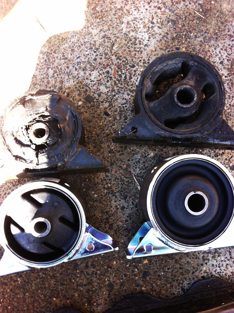

I changed mine today.. But not sure weather I put them on the right way

Re: DIY: Changing lower engine mounts
Yeah looks right
Wrong square holes facing outwards,
just letting you know I installed the ralliart insets a while back and notice a few weeks later the housing was cracked. Not sure if it was me, or the mounts are too big.
Transgold mounts dont fit an FTO.
The ones from Meek?payaya wrote:just letting you know I installed the ralliart insets a while back and notice a few weeks later the housing was cracked. Not sure if it was me, or the mounts are too big.
Better late then never yes meek are the ones Mitsubishi stock. I've had the same insert in a replacement housing and no cracks. I must have fucked it pressing them.
