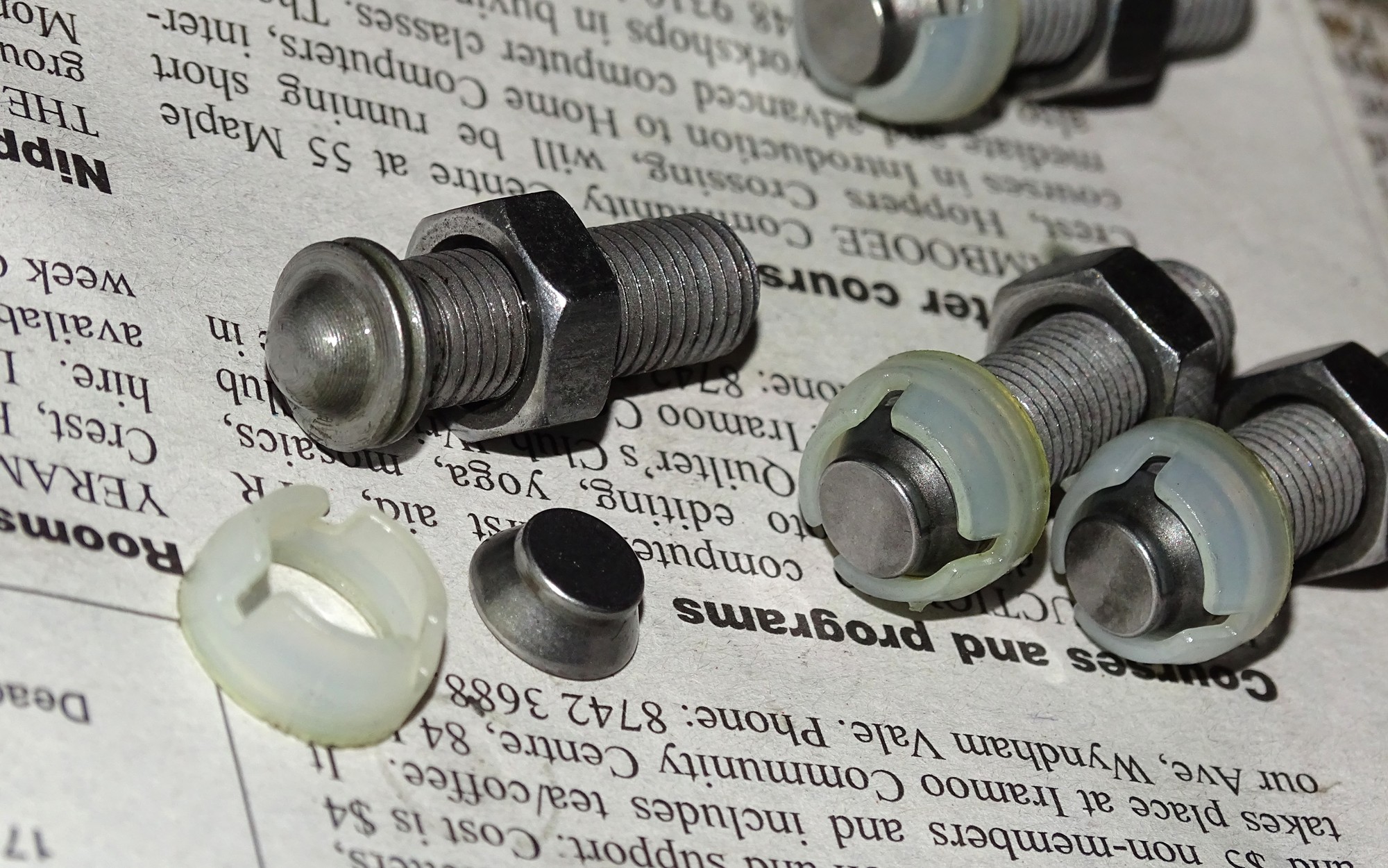

I pasted this in the aftermarket parts section but I'll paste it here too:
Valve Adjustment Screw - Collet and Shim ONLY!
Part number: MD180514
You can't use the screw due to incorrect length and thread since it's from the 4D series engine. But if you are looking for replacement plastic collets or lost shims which are prone to getting brittle and breaking I found a supplier at a good price:
http://www.kowze.com is their website but they are a trader on alibaba.com
The company is happy to trade outside of alibaba if you add Dias on Whatsapp +86 186 4530 9333. They will issue you a pro-forma invoice and you can pay via Paypal. The price will depend on the quantity you are buying......remember there's 24 of these in a MIVEC engine. I paid $1 USD per item and shipping cost $25 USD. They landed roughly 1 week after I made the payment.
They are a Mitsubishi parts supplier so I'm curious what else they may have.

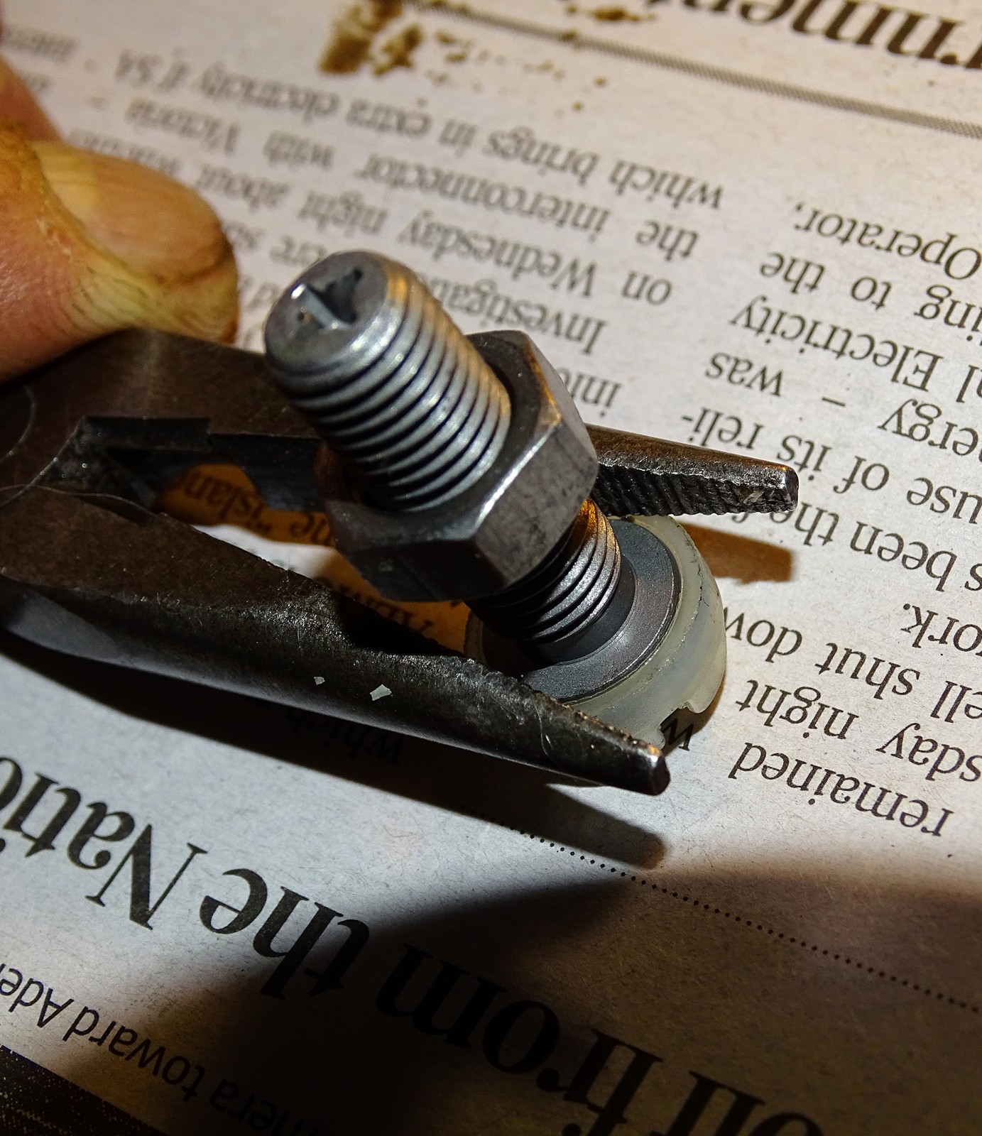

- I used the edges of the pliers to remove the collet. It pops off with enough force......not too much though

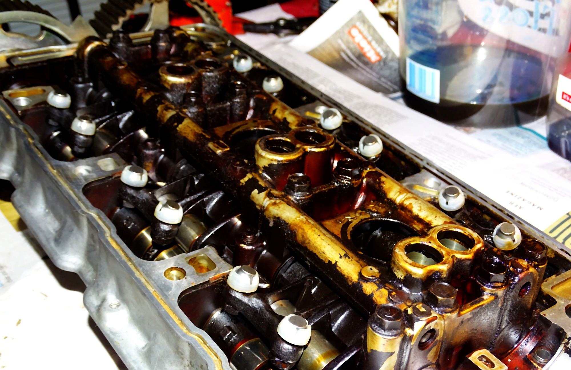

I had two engines to do so I ended up buying 50 pieces.
The engine I'm working on had all 24 of the f*ckers missing. Now I've most likely gotta pull the sump so see all the dropped ones in there

They look pretty good to me.....at the end of the day it's plastic and it looks and feels the same as the FTO collet. But I did notice that the thinnest part of the collet on the 4D set is about 2-3mm taller than the FTO collet which suggests that it will be less likely to break because of the extra plastic. All of the broken collets I've seen in an FTO were from the thinnest part of the collet.getonit wrote:Nice work Nacho, let us know what you think when they arrive. Looking at some myself now.

I'd say these things break because people do not get them adjusted and hence the collet has strain on it to keep that little metal shim piece in place. Obviously over time the stress cracks it.
If the clearances were adjusted regularly then these collets wouldn't have to work to keep the shims in place and should hence last a long time.
As mentioned before all 24 of those plastic collets on my engine were intact, I did however break one myself accidentally.
