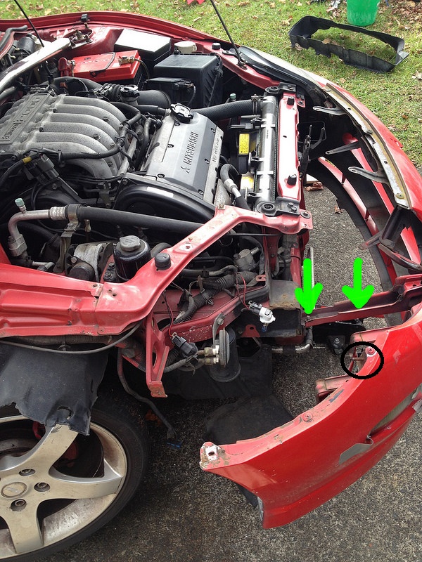

Have you removed the bolts from below that go into the chassis rail? Looks like one is still in the thread on the driver side and you've bent the reo yanking it off.

ImageIMG_5382 by bryanplimer, on Flickr
these 2 must be cut off or sheared off or something... were doing nothing but were the ones i expected to get to...there are *none* on the passenger side as far as i can tell...

They'll be inside some holes in the square chassis rail from below.

that's how you are supposed to access the 2 pointed out in green eh?
Posts: 3955
Re: HELP!
Yes. 12mm bolts

there are none
Re: HELP!
There's sometimes another bolt up behind the headlight that could be the issue.
Circled in black here.

That's not a bolt, that's just a alignment pin. Just slots in. Not held in by anything
Re: HELP!
They're threaded (or at least mine and a friends was), I've found bolts in there before, just many don't put them back in.

passenger side alignment pin had a nut - nuts!
Re: HELP!
Well there ya go. :lol:
Re: HELP!
Thought it might, it's a bit of an annoying place to have one, and I know of no one to put them back there too.

Technikhaus wrote:Thought it might, it's a bit of an annoying place to have one, and I know of no one to put them back there too.
Maybe that's why every second FTO has poor bumper alignment haha
Re: HELP!
That's because here not meant to be there
