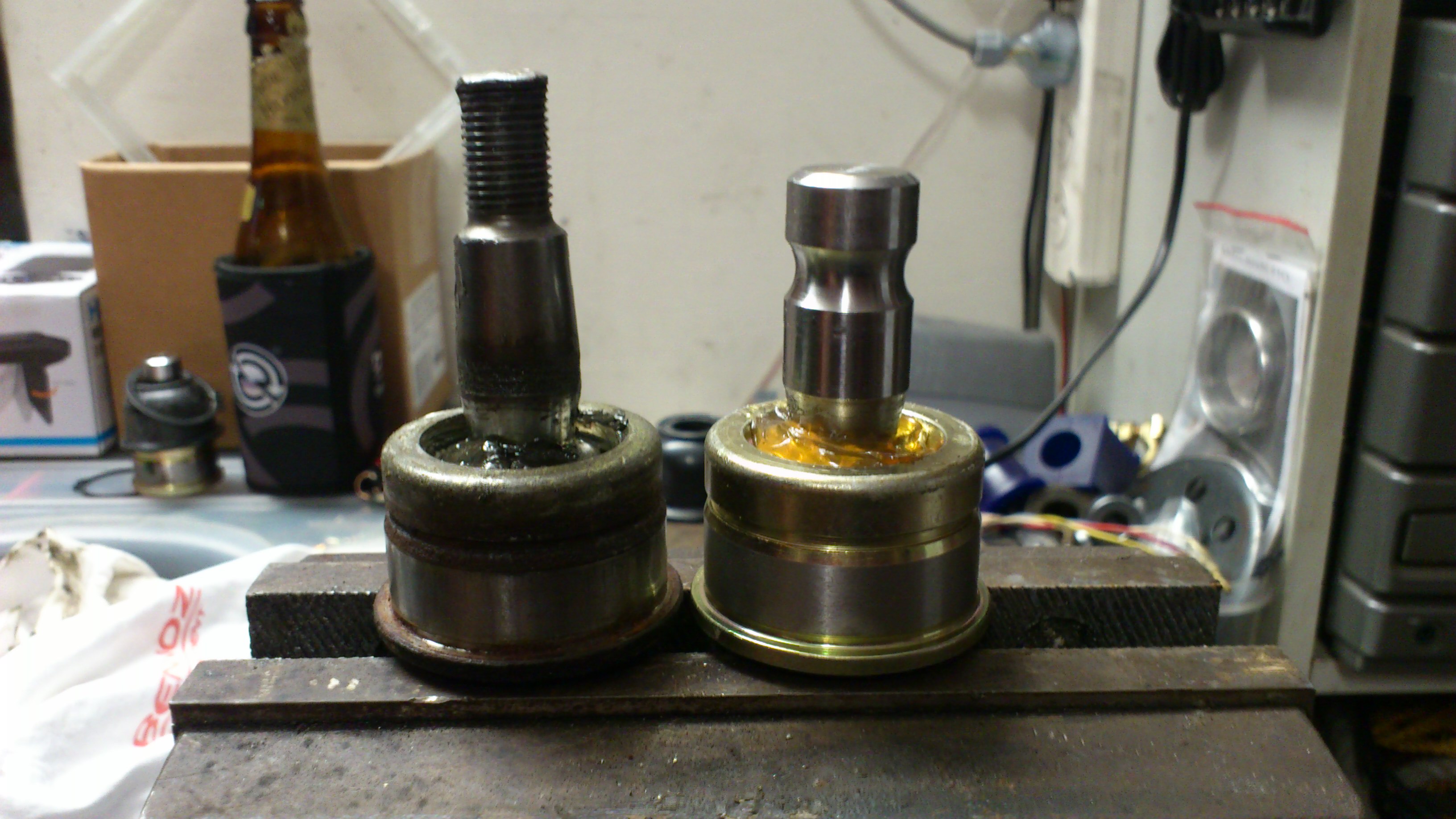

Vectose wrote:They do, just need to swap the ball joint to an EVO 5 one. Bennoz has done it.
Aren't E3 and FTO ball joints the same though? Meaning that the E5 ball joints would theoretically fit FTO LCAs?
Re: GPvR LCA Compared to GPX
Yup, should. But may need to machine a new groove in ball joint for the circlip as the surface area where it presses into is less than the EVO 5 arms.
Posts: 23676
Yeah the E5 ball joint should theoretically press straight in FTO arms.
It's when you go the other way & try put the FTO/E3 ball join into the E4 or 5 arms where you need to machine a new circlip slot in. A service they apparently provide at Meek, where I got most of the information to do my conversion.
From what I understand though, FTO ball joints are not replaceable, in the sense that you can only buy complete LCAs from Mitsubishi as they claim the metal is stretched and weakened by pressing ball joints in and out.
There are of course aftermarket replacements available
