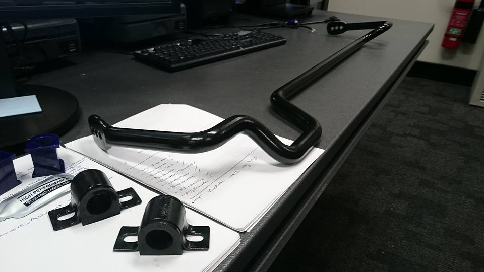

Yeah I did. Good bit of kit. Recommend upgrading to the later model car mounting brackets with the double welded top on them. Otherwise you have to drill the lower hole on the early versions (which aren't as strong).

Are you referring to the FTO brackets for a facelift or pre facelift or are these different types of Shelby brackets that come with the bar?
I've literally just bought a brand new set so I assume they will come with new brackets but I'll ask to be sure.

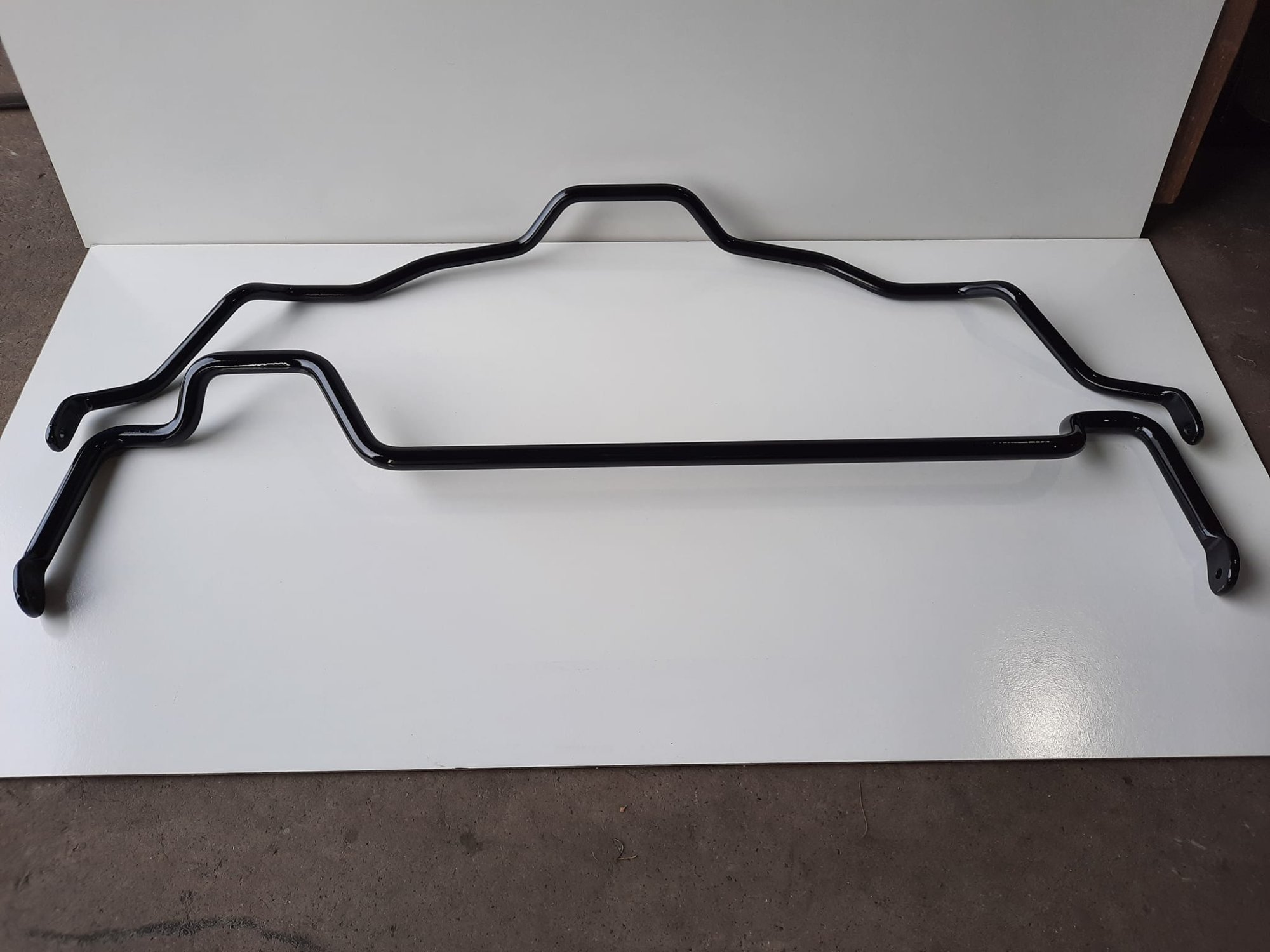

Front and rears
Re: Selby/Signature swaybars
Posted: Tue Jul 20, 2021 5:39 pm
by spetz
What size are those?
And are the hollow or solid?
Posted: Fri Jul 23, 2021 9:03 am
by d_dan
22 rear & 26mm front solid spring steel

Do you mean 22 front and 26 rear?
Posted: Sat Jul 24, 2021 7:43 am
by d_dan
Ohh lord I hope so. The RPW site actually says 26 front and 22 rear but it doesn't make sense.
Also the pic shows the rear one looking thicker than the front.

They come with bushes & a mount bracket, but the bracket that it mounts to on the car needs modifying. If it's an early model, you'll need to drill a hole in it, as their bush mounts are dual hole, not hole & slot like the FTO.
I then found the bracket on the car to be cracked, so after all that effort, I just ordered some late model CH lancer brackets from Amayama. Came with 2 holes & a reinforcing plate welded to the top.
