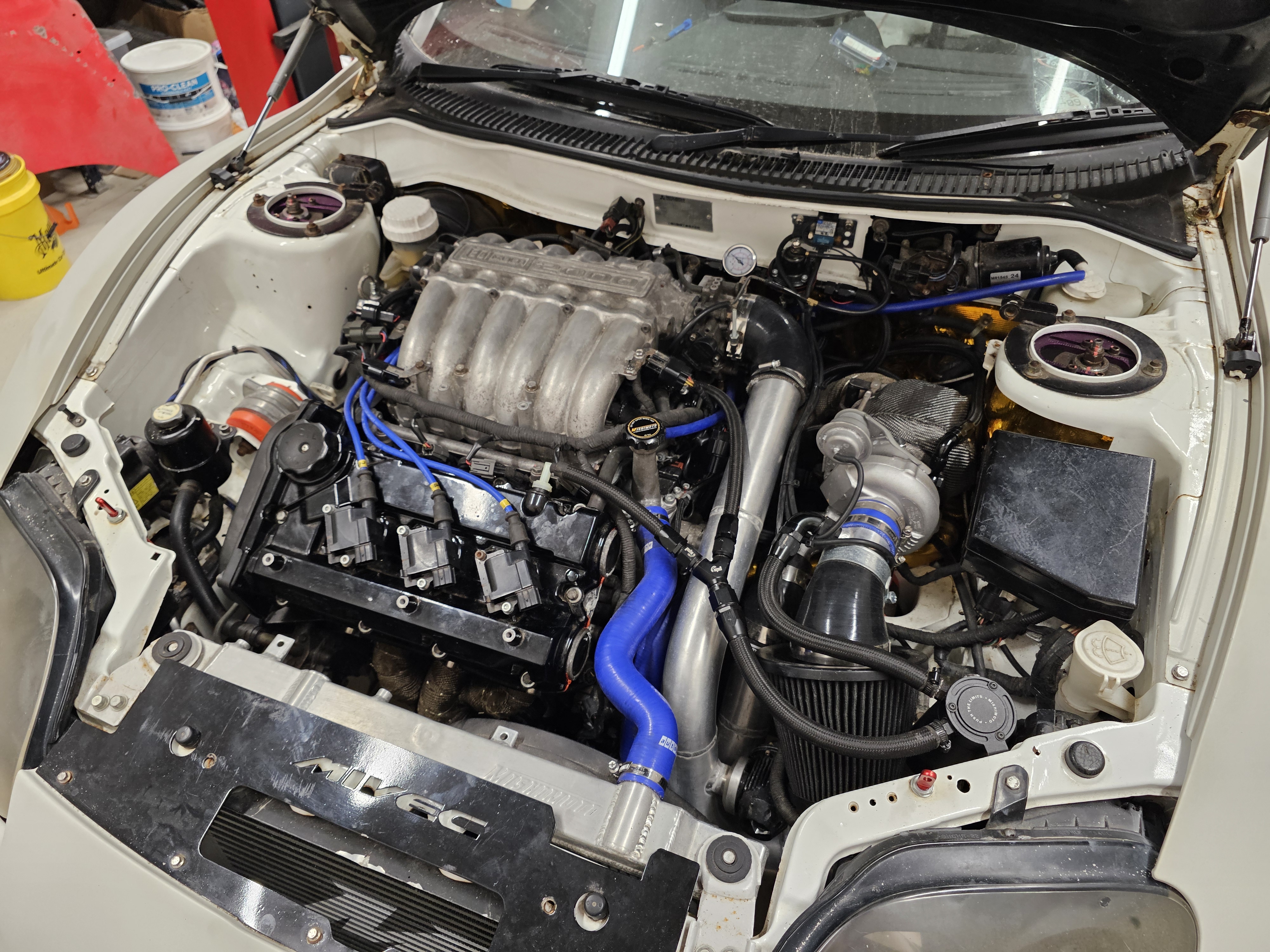

Well I suppose 14 years later it's time for an update :lol:
Long story but I lost this car for almost 8 years.
But I've spent the last 6 years restoring and rebuilding the engine.
She's had her first outing on track last week for a shake down and all went well.
Current spec is:
Engine
Magnicor Plug leads,
custom profile exhaust cam shafts with 12° reduced timing on each lobe,
VF35 turbo,
Bosch, 600cc injectors (Custom Bosch EV1 to Denso adapters)
180° rotated and dead head conversion fuel rail
Holley Hydramat
Mishimoto CRX Twin core aluminum radiator,(stacked with IC)
Sytec fuel pressure regulator,
ARP head stud kit,
Blitz SSQV black edition dump valve,
Mishimoto G series intercooler (Stacked Infront of radiator)
Custom hardpiping
Samco hoses
ACL Tri metal trust bearing
ACL Tri metal main bearing
ACL Tri metal conrod shells
Accusump oil accumulator
OBP 10 row power steering cooler (offset divers side wheel arch)
Setreb 15 row oil cooler. (Offset passenger side wheel arch)
HEL multi angle thermostatic sandwich plate
Exhaust
Pro shop idia equal length stainless manifold,
Pro shop idia stainless downpipe,
Pro shop idia stainless turbo intake & downpipe,
Decat,
5zigen Pro racer A spec cat back.
Suspension & Gearbox
Silvers Neomax R - black edition 10k front 12k rear
Silvers adjustable topmounts,
Upper front strut bar,
Upper rear strut bar,
Exeddy 3 puck paddle clutch.
Cusco RS 1.5 way LSD.
C's Short shifter
Full suspension poly bushings& nut and bolt rebuild
Signature Sway bars 18mm front ARB & poly bushings
Signature Sway bars 22mm rear ARB & poly bushings
Hard Race adjustable TOE control arms
Super pro adjustable camber bolts
Brakes
Steel braided hoses front and back,
Pagid RSL29 front pads
EBC yellow stuff rear pads
Alcon mono6, 6 pit calipers
EBC 330mm vented Disks
APR front/rear brake bias
Full stainless steel brake hose plumbing
1 & 1/16 brake master cylinder
Interior
OMP RSPT2 driver's seat
OMP TRS passenger seat
Fia seat rails
Single piece aluminum seat rails
RRS R6, 6 point harnesses,
Harness bar.
Carbon fiber boot to the interior divider,
Exterior
Carbon fiber bonnet,
Carbon fiber boot lid,
Bozz facelift bumper,
Pro shop idia rear apron,
Pro shop idia side skirts,
6k HID low beam's
Carbon look Aerocatch's
Creative adjustable spoiler
Race Louvres center and side bonnet louvres
Alloys & Tyres
17" Work CR KAI 7J - WETS Michelin Pilot Sport 5 225/45/17
17" Work CR KAI 9J SEMI SLICKS Nankang CRS 235/40/17
Electronics & Gauges
Maxxecu Race standalone ECU
CUSTOM plug and play harness
AEM Boost pressure gauge
AEM Air Fuel ratio gauge
Racetech dual oil pressure/ oil temp gauge
Dedicated oil pressure gauge for Accusump and manual oil pressure valve.
Dedicated digital oil pressure sensor for ECU
Individual wheel speed sensors connect to ECU
MTune digital dash
Power
280 crank hp
235 whp
220ft lb
@0.6 bar boost.
