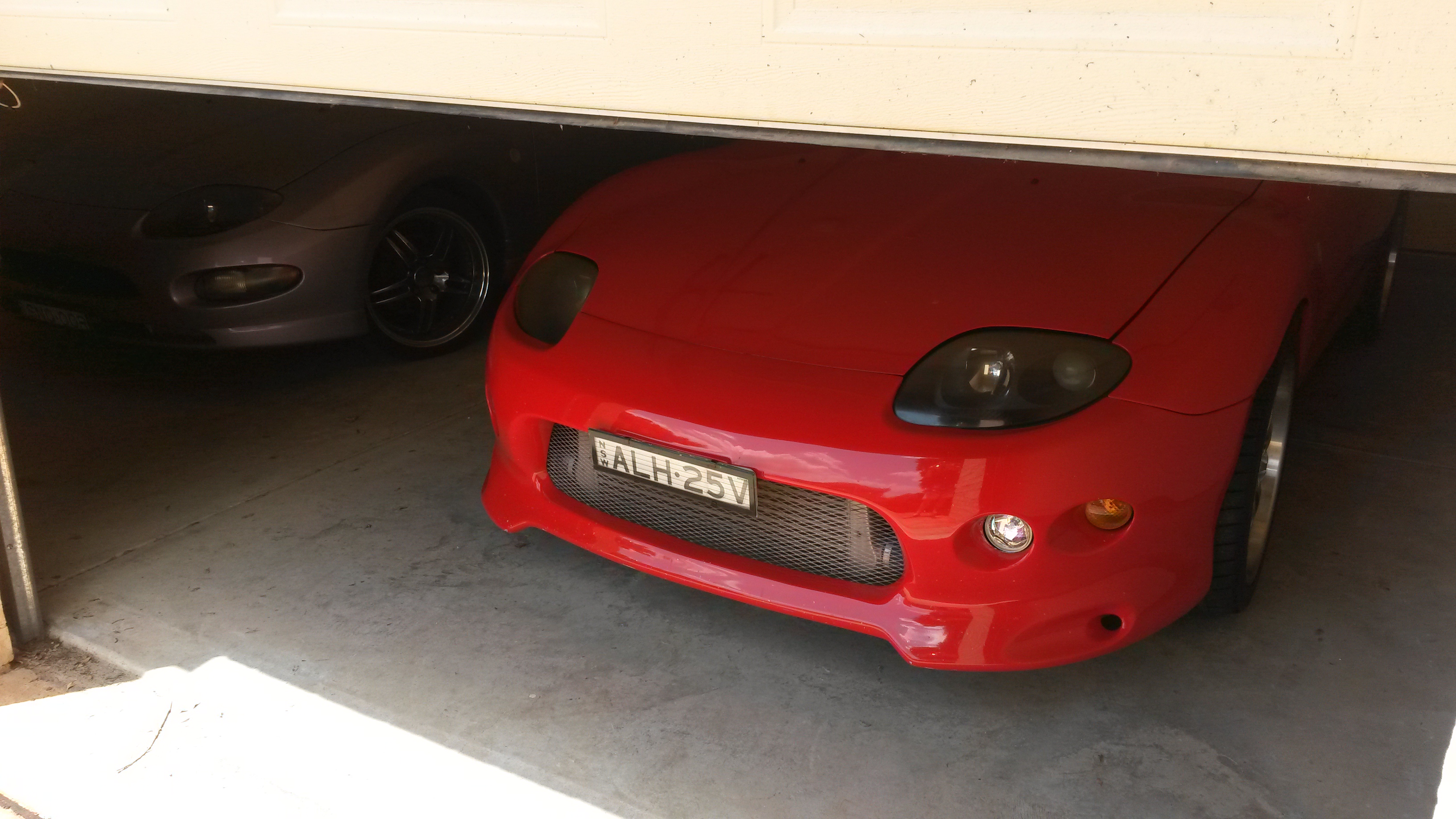

Well, she's getting a wash & being put in storage today. Too many cars in the driveway...
But there is some good news amongst it, I'm sending my spare 6A13 out to my engine builder next week. Time for some forgies!
Also on the hunt for an Evo box if anyone spots one going cheap. Doesn't matter if it needs a rebuild.

To be honest, I'm at a bit of a crossroad with her at the moment. Was contemplating selling her, but then what will happen when I turn around in 12 months time & think 'sh*t, I'd love to go racing, but don't have a car.'
Or... do I turn her into full blown race car? Strip it out & throw it on a trailer?
Then... what happens when I'm keen to go for a cruise up the mountains or similar on a Sunday? I can't cause it wont be registered or street legal anymore...
So many decisions!
She needs a new box, this one in it is starting to knock (just like all the other ones lol) and the motor is starting to a fade a little. Too many kms with too much boost. Hence the new one.
So storage is a good call I think lol. Give me time to think about what I want to do with her. She's got 12 months rego, so can still come out for cruises etc!
