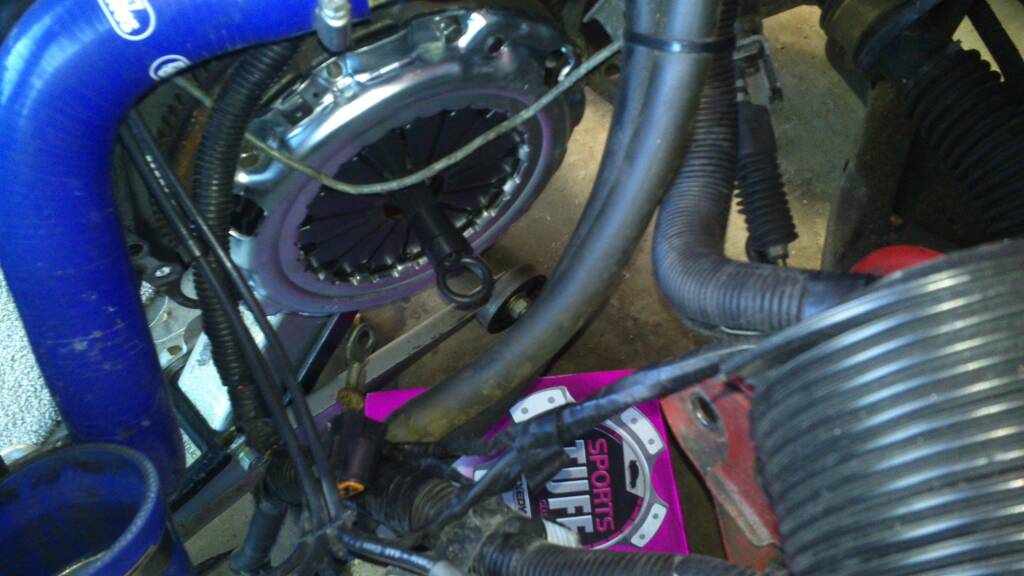

Progress :cheers:
New clutch in
Re: Bennoz 6A13 Conversion
What clutch is it?
And how do you rate it?
Erm, think it's a MBK-6249HD from memory. Heavy duty to suit Evo III.
Same organic plate the FTO kit uses, just a heavier pressure plate. Heavy under foot, but easy to use. Never slipped on me.

Bennoz wrote:Erm, think it's a MBK-6249HD from memory. Heavy duty to suit Evo III.
It's MBK-6429HD
Bennoz wrote:Same organic plate the FTO kit uses, just a heavier pressure plate. Heavy under foot, but easy to use. Never slipped on me.
Is that in comparison to the HD FTO kit?
Yup.
