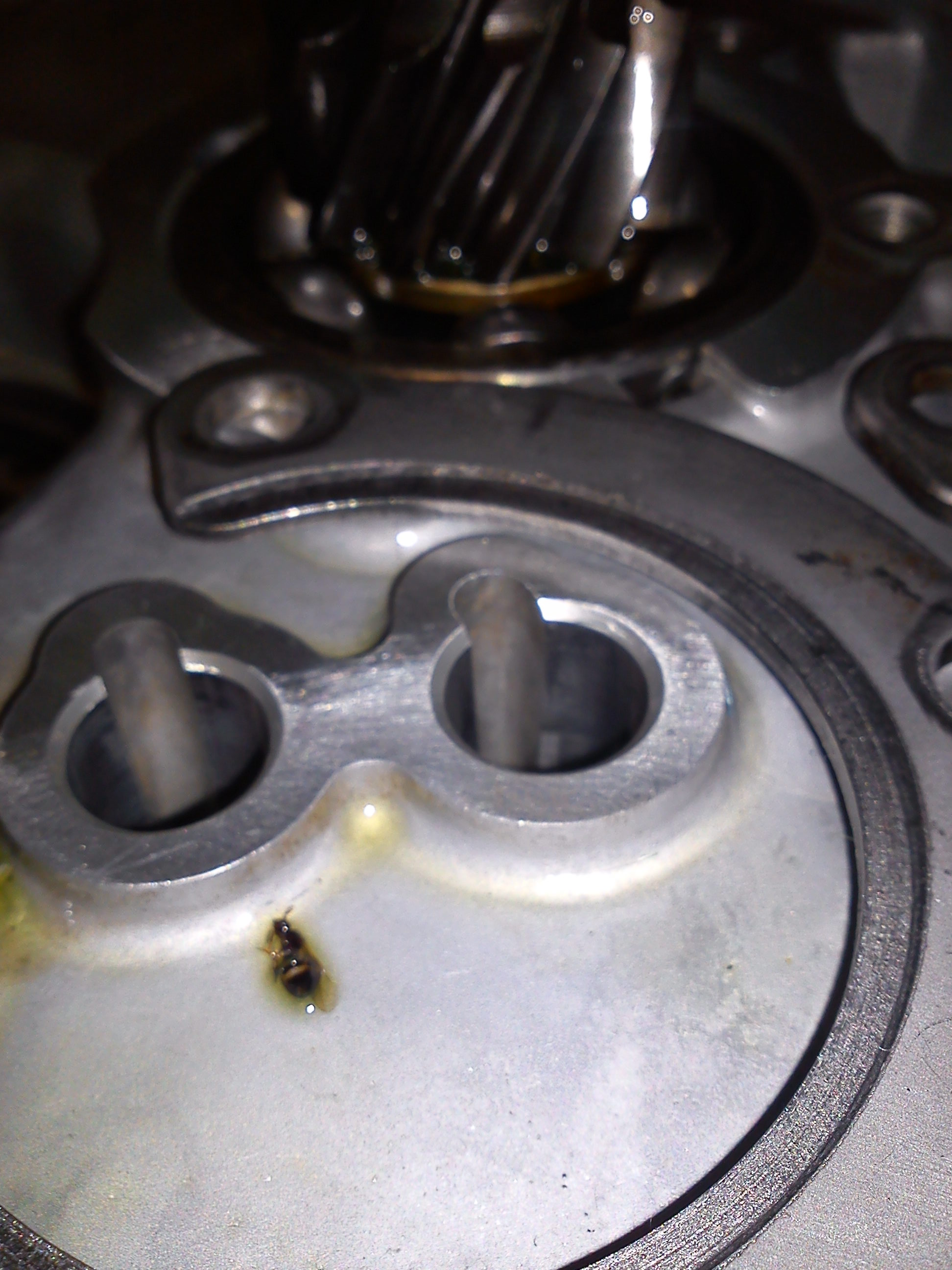

Big in indications of clutch chatter. Some very pounded & shiny springs in the plate...

So it appears I've spun 2 bearings. The old chestnut, the primary input bearing, and this time the secondary input shaft bearing. Both have torn up the casing pretty good.
Going to see if the case can be sleeved. Otherwise, I'll have to strip down another box I've got here & do an internals transplant.
All because the primary bearing has once again collapsed & chewed out the retaining plate...again.
Think this time I'll get that plate made out of something stronger.
