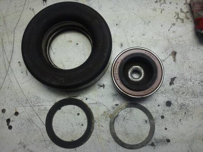

Figured out what caused the belt spit, idler pulley almost seized. Finally figured out how to press the bearing out rather than having to replace the whole thing
- uploadfromtaptalk1332194763019.jpg (49.79 KiB) Viewed 812 times

What is the cost difference between getting a hole new setup versus just the bearing?
- Posts: 23687
Re: Bennoz 6A13 Conversion
Went to both my bearing guys & neither could help me lol. Its a proprietary bearing made by Koyo for Misti. So I'm getting a quote on a new one from Ralliart NZ.
Mitsi Australia want $170 & Camskill dont even list them (unless I'm blind)
