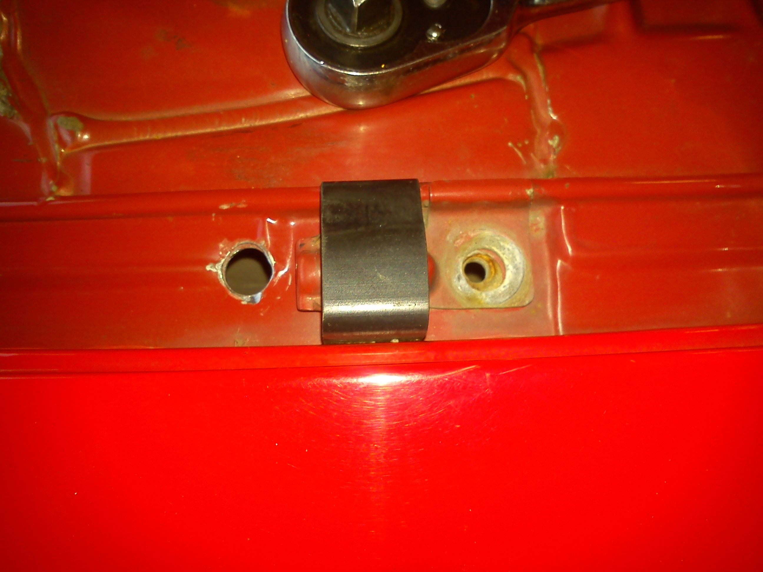

Some piccies

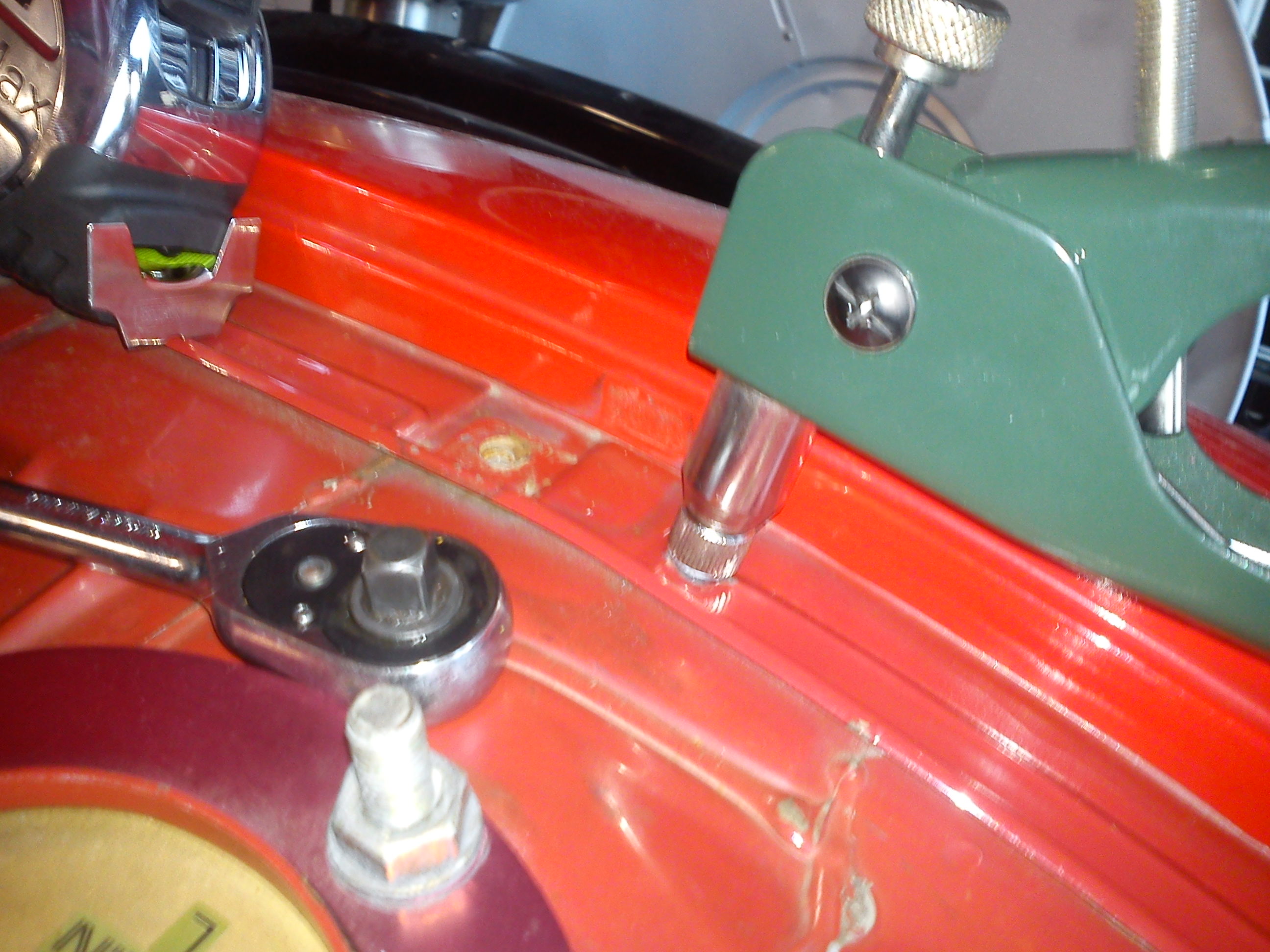

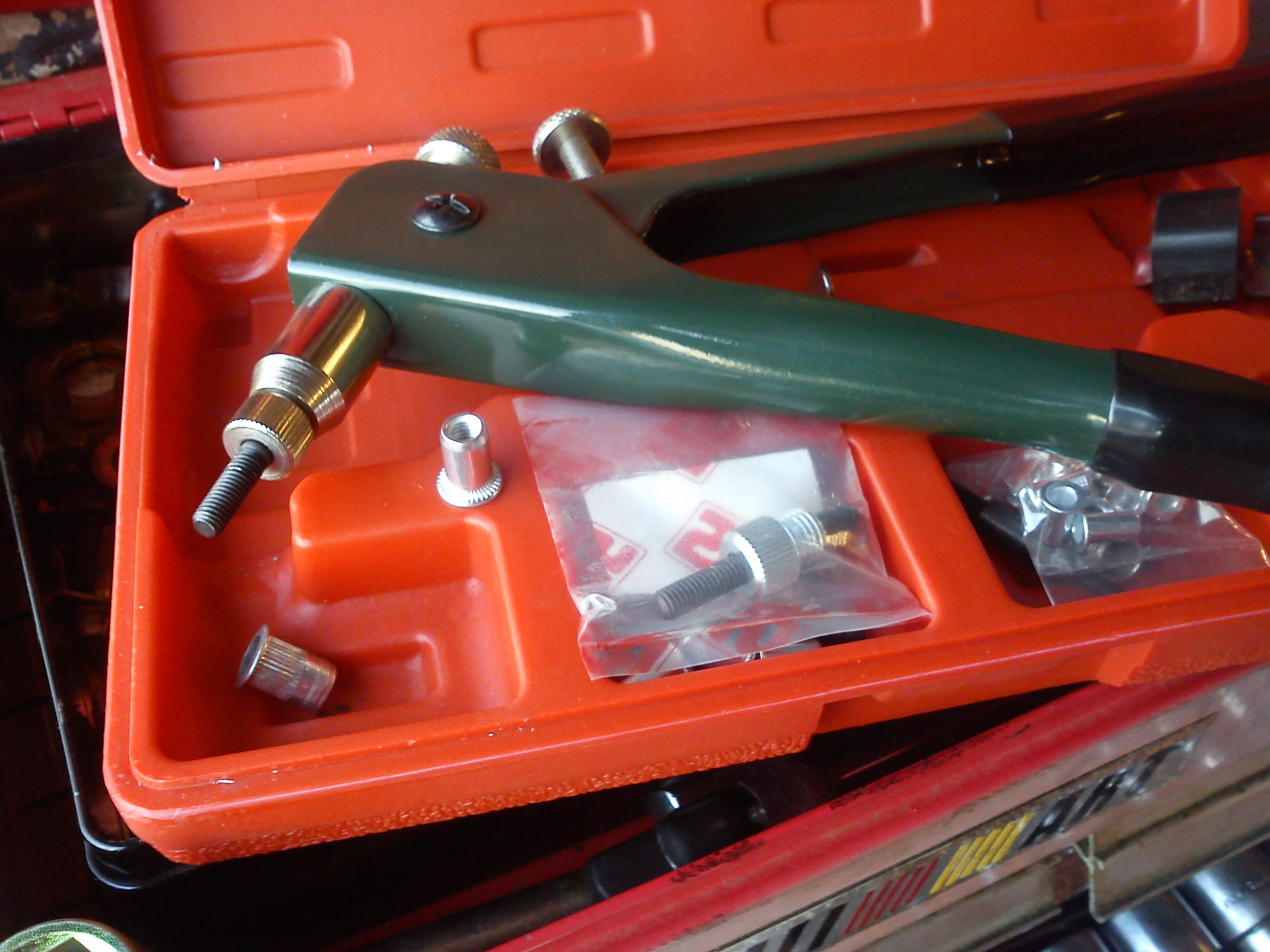

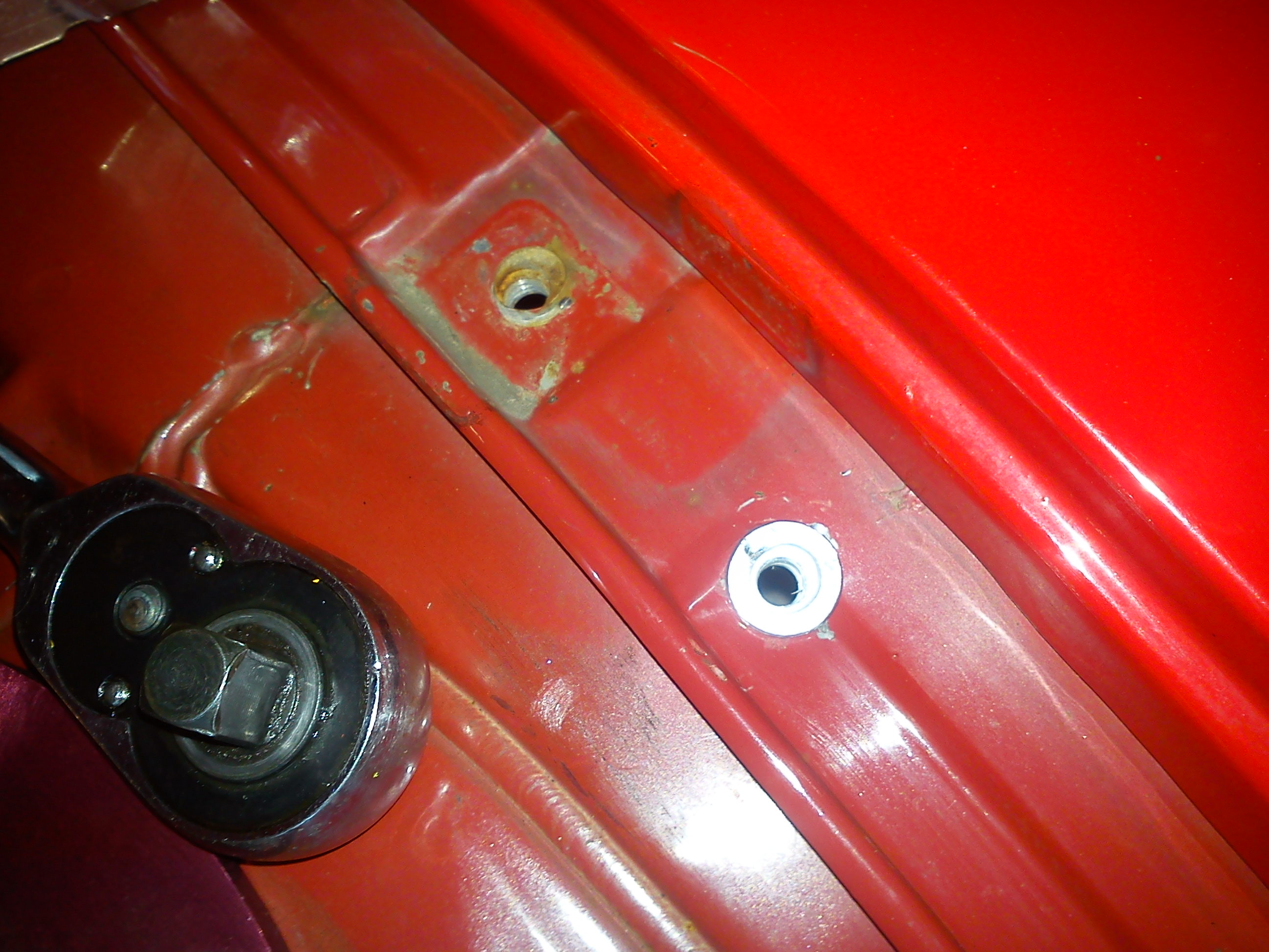

What's that rivet gun / thread thing you've got there Ben?
Posts: 23676
Re: Bennoz 6A13 Conversion
Its called a 'nutsert' gun, or 'blind nut' gun. Very much like a pop riveter, but it inserts threads into places where you can't get a nut to the back of :)
Why has no one ever told me about these :evil:
Better get me one, could come in very handy :)

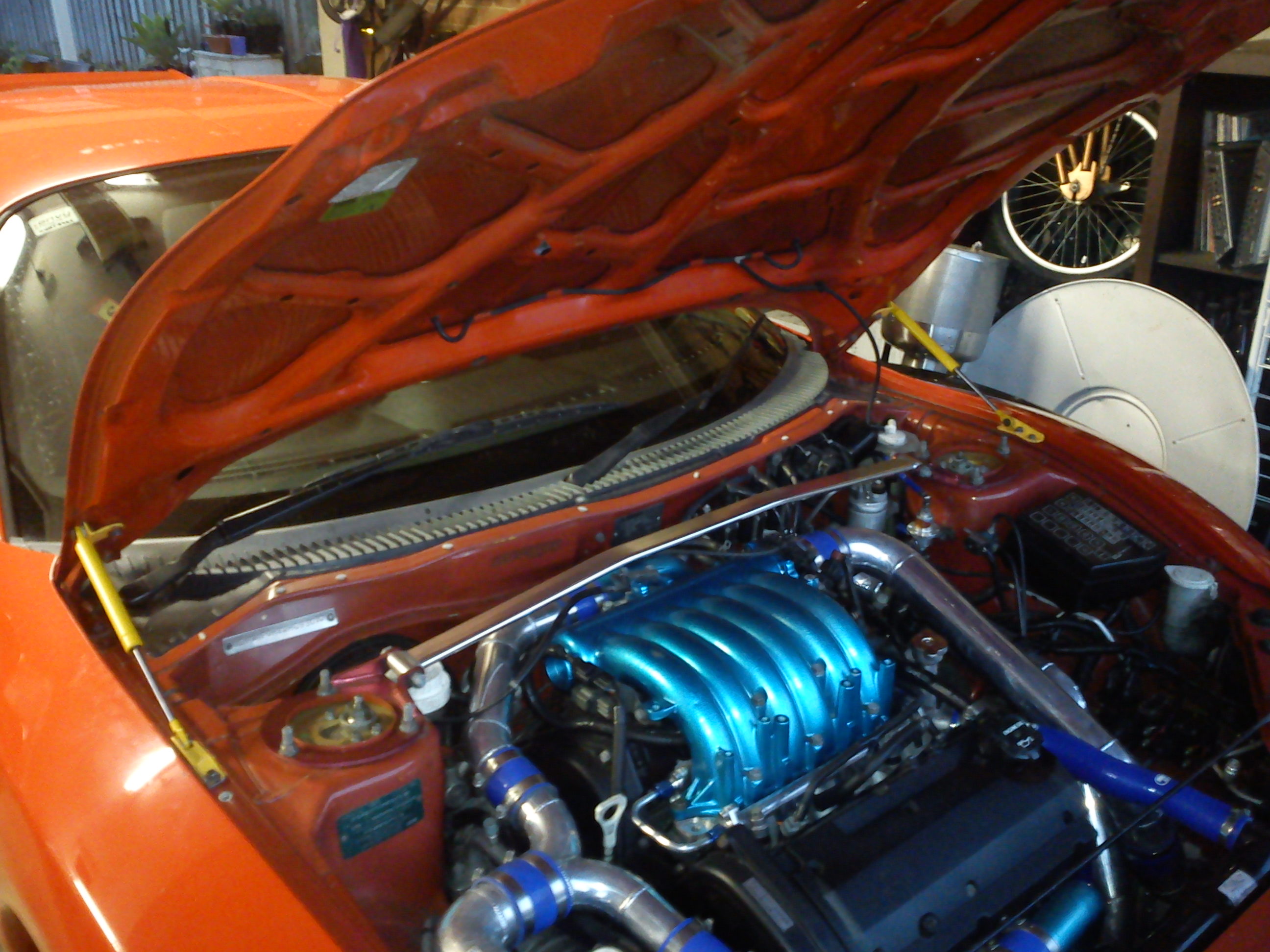

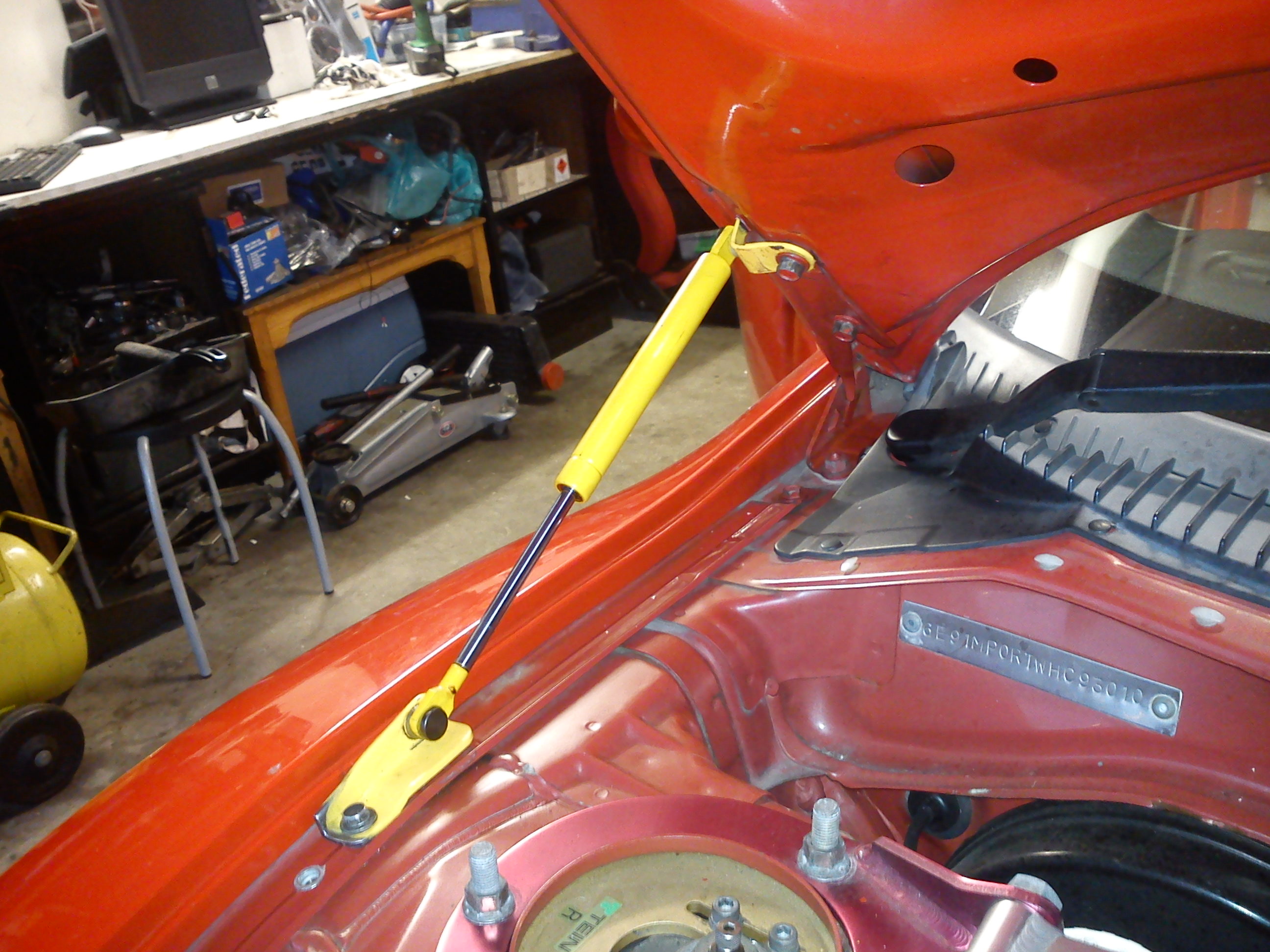

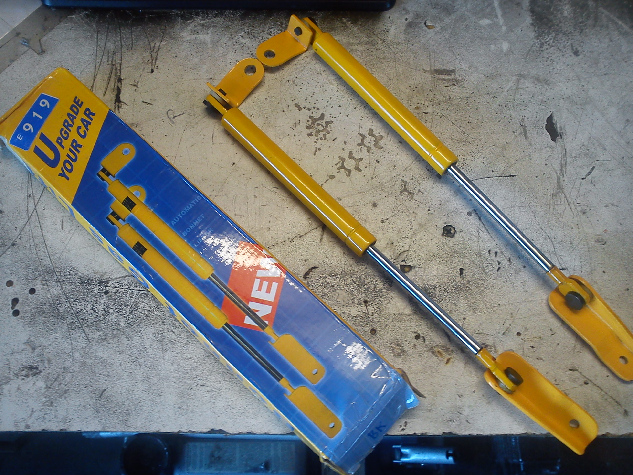

Nice work there ;)
Do the struts weigh much?
Posts: 23676
Bout the same as the oem bonnet stand & associated :lol: brackets that I removed
*cough* DIY DAY *cough*
Showed me these last time was there, been waiting for the finer details since. :lol:
I installed these exact struts in my FTO last week.
http://www.ebay.com.au/itm/universal-ca ... 3effb3c744
All I had to do was drill a new hole in the bottom bracket of the strut. Other than that they fit perfectly.
Reckon you could use boot lid ones? Or are they to weak?
