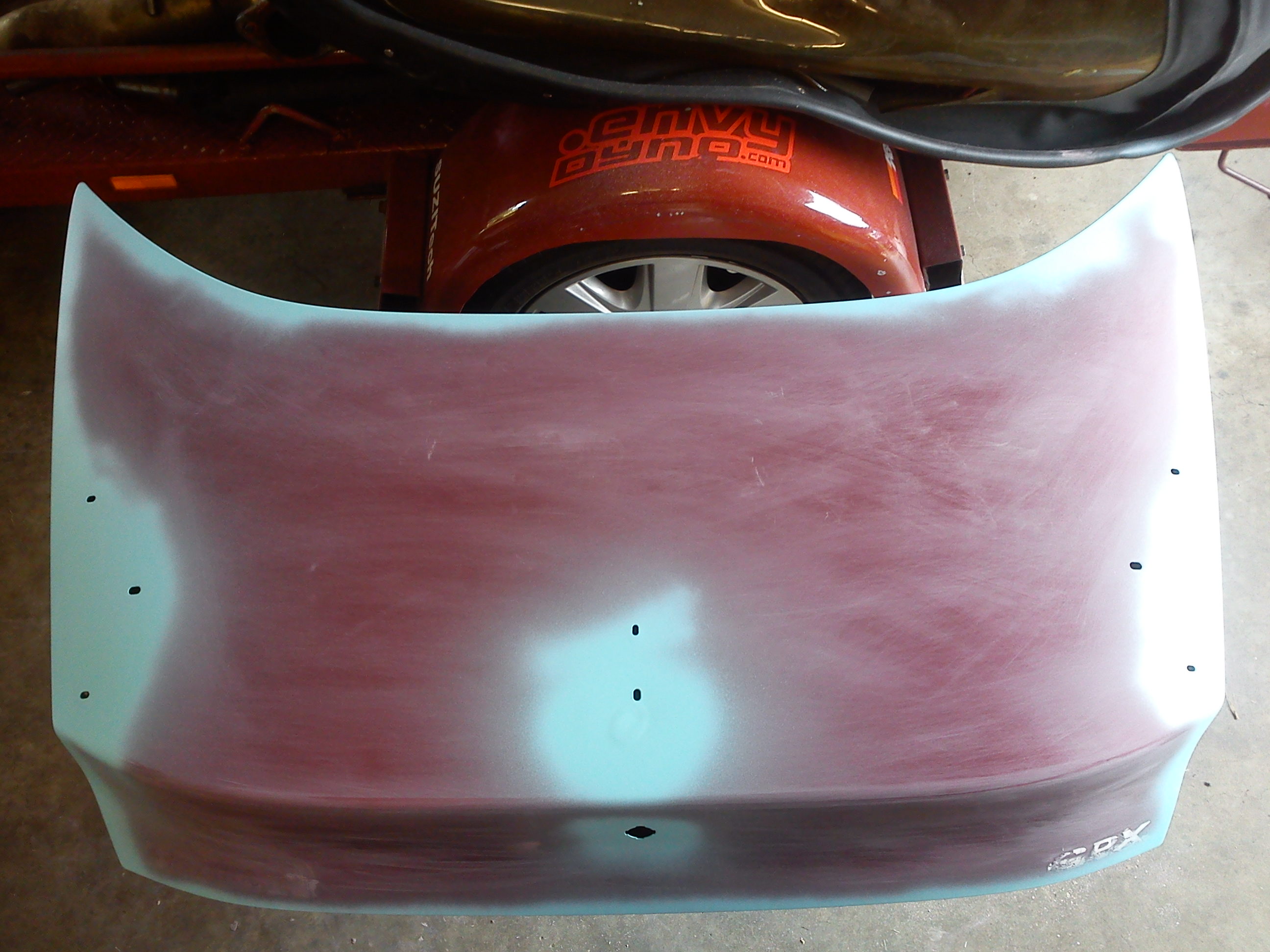

My secret shame... I can do body work :oops:
This is a spare boot lid, gonna tac up the holes & give her a coat of red, see what the beast looks like spoilerless :)
Also got some other cool body stuff coming up. Especially seeing as I've run out of mechanical things to do :lol:
