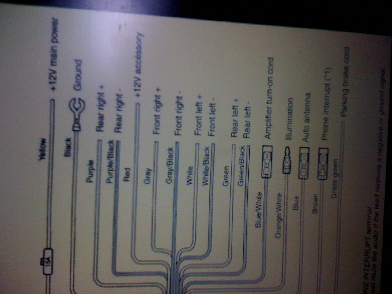

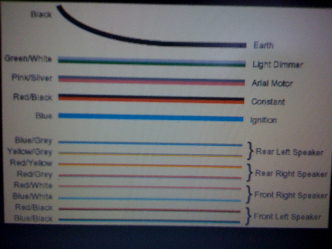

Most of them are the same
Fto stock diagram
My kenwood double din
