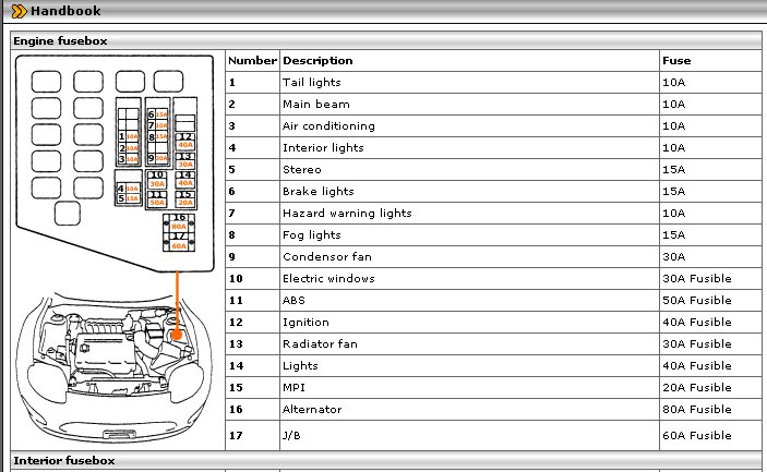

Hey guys i have a 1995 fto 2.0 v6 and the thermos seem the stop working i tested them on the batt and they work looked athe fuse box and i would not have clue where to start as it is in Japanese
any other ideas why there not working?

Thank you so much now to test this fuse and go from there :/

fuse looks fine is there some sore of temp that these fans kick in at like a sensor thats could be lose?

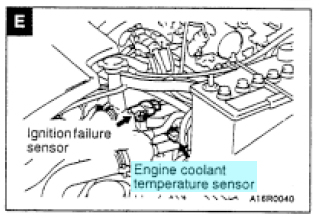

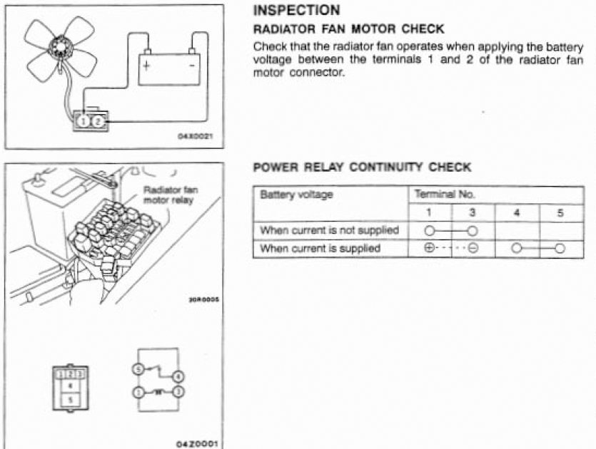

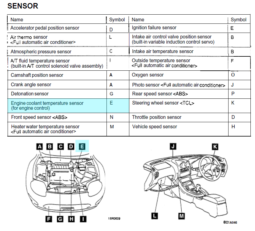

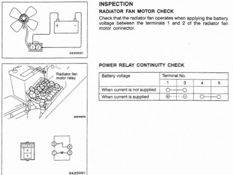

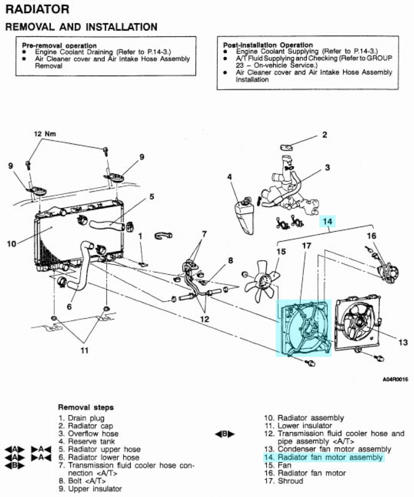

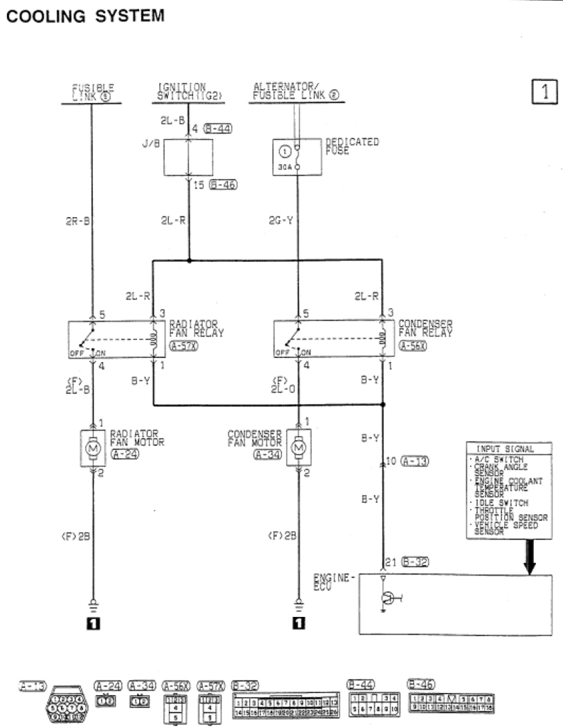

Re: Thermo fans
Thermo/radiator fan is on the passenger side of the FTO. It is operated by the ECU. The ECU gets it's engine temp readings via the Engine Coolant Temp Sensor.
So the Engine coolant temp sensor reads the engine/coolant temp, sends the readings to the ECU, the ECU then turns the fan on/off as required.
The ECU sends the fan on/off signal through the Radiator Fan Relay (as pictured), the fan receives battery power through a fusible link (Fuse #13 as pictured).
Some more info...
Some more info...
- Engine coolant temp sensor 02.jpg (72.34 KiB) Viewed 199 times
