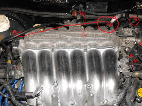

Is the stepper plugged back in properly?
Is the intake pipe seated correctly on the throttle body?
Did you break, pull off or bump off any vacuum hoses?
- Vacuum02.jpg (143.89 KiB) Viewed 266 times

I don't even have a number 3
(since I got it over 2 years ago)
Everything else is good, no spilts etc.
