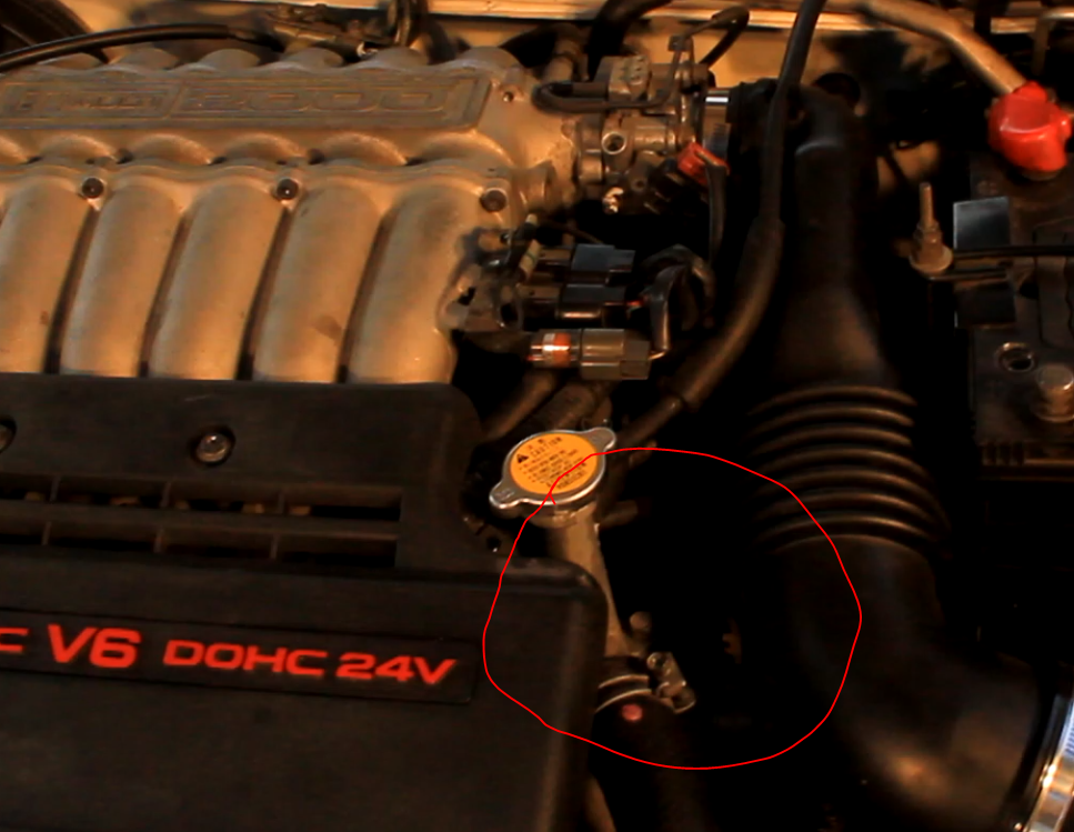

Re: Idle not working on the speedo
If it's the IFS, then it is to about here..
Excuse the horrid picture, it should be bolted to the engine, with a wiring loom connected to it.

If your ignition sensor has failed your car won't start?
Dead tacho is usually the IFS. It has happened to quite a few people here now, including me. The car started without any dramas for 2 years before I changed it over.
