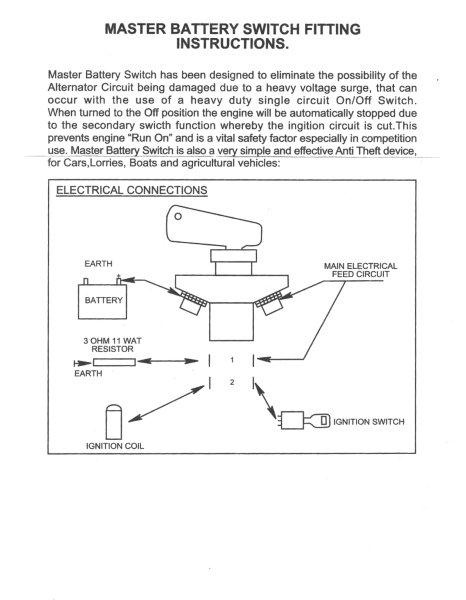

Following is the diagram for the switch itself.
The positive terminal of the battery is rewired through this switch, with one side of the switch connecting to the battery and the other side of the switch connecting to the main positive connection on the starter motor. This connection to the battery replaces all existing positive connections to the battery. This wire (from the battery to the switch to the starter motor) should be very heavy guage (on my race car this wire measures a little over 10mm in outside diameter). This is the main terminal on the switch.
You will then see two additional pairs of blade connectors on the switch, one pair labelled 1 and the other labelled 2. The pair labelled 1 is very important as this protects your electronics from surge when suddenly throwing the switch. One side connects to the positive terminal that connects to the starter motor, the other side connects to an earth through an 11W 3ohm resistor (which should come with the switch).

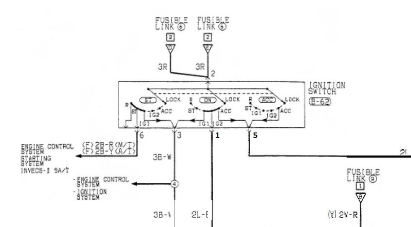

The pair of blade terminals labelled 2 connects into your ignition wiring on your ignition switch. On the FTO this is pin 3 of the ignition switch connector, on my 95 GPX this is a thick black wire with a white stripe. You basically cut this wire and connect one side to one of the blade terminals labelled 2, and the other side to the other. So you are basically wiring the kill switch blade terminals labelled 2 in line in the ignition switch terminal number 3 wire.

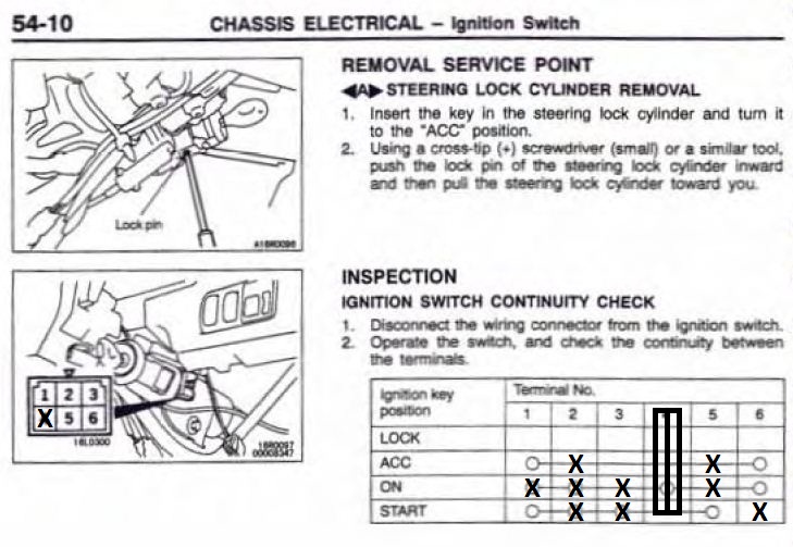

Following are (corrected) diagrams from the FTO Electrical and Workshop Manuals showing the connector and the wiring diagram for this switch. I say corrected as when I verified these connections on my 95 GPX the 'Ignition Switch Continuity Check' in the manual was all wrong, but if you look closely my 'corrections' do correspond correctly to the actual wiring diagram from the Electrical manual.
As with anything I would strongly recommend you verify and confirm the connections on your own car before making any modifications. From the limited electrical work I have done with my racecar so far with reference to the manuals and other diagrams that are available for the FTO, there are quite a few little corrections that I've had to make for my specific model FTO.
