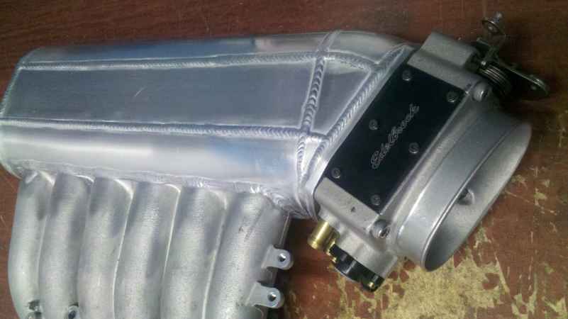

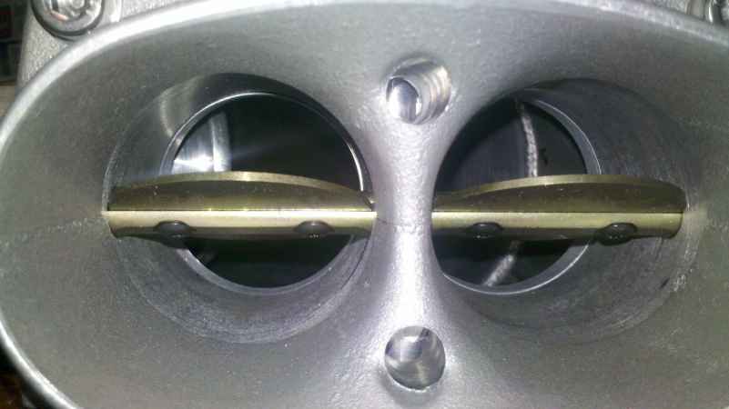

* Modified intake manifold with removal of the duel runner system, fitted with a Twin 52mm Edelbrook throttle body, internal ram tubes and increased plenum chamber volume

* Intake Manifold 90% completed - check updated photos below

And have the runners been shortened at all on the manifold?
What is the purpose of this FTO?

Runner lengths have been made slightly longer (By the time you add the slight extra length of the internal ram tubes) of the original short runner length on a stock manifold.
The longer the length, the more torque you can create. But the actual inlet size going into each runner, is now larger as we are not restricted like the stock manifold.
It was a balancing point of trying to retain midrange torque as well as of course, upper rpm power levels. Only other option would have been to go to individual ITB system but in my opinion, becomes too difficult to tune and loses all driveability on the street.
As for the purpose of the vehicle, I believe it is intended as a pure circuit / targa racing vehicle but remaining in the under 2.0 class.
