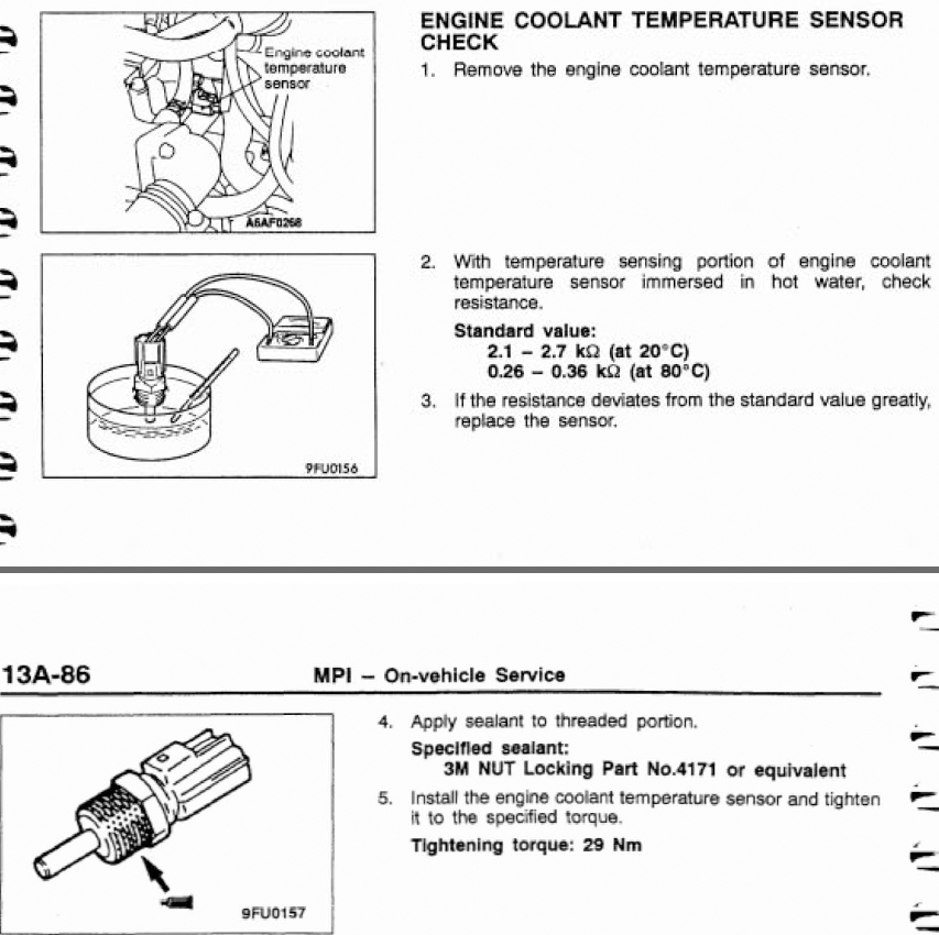

Maybe your new coolant sensor isn't working.Daniel2019 wrote:Fans working when A/C is on high.
f**k it, I give up for today
Unplug the wire from the sensor and bridge/connect the 2 terminals on the plug, start your engine and your fans should turn on. Even with the coolant not hot yet.
You can test the sensor if you have a multimeter...
Re: Fans not always working
I will test the other sensor that I bought and if it works then ill swap them again
