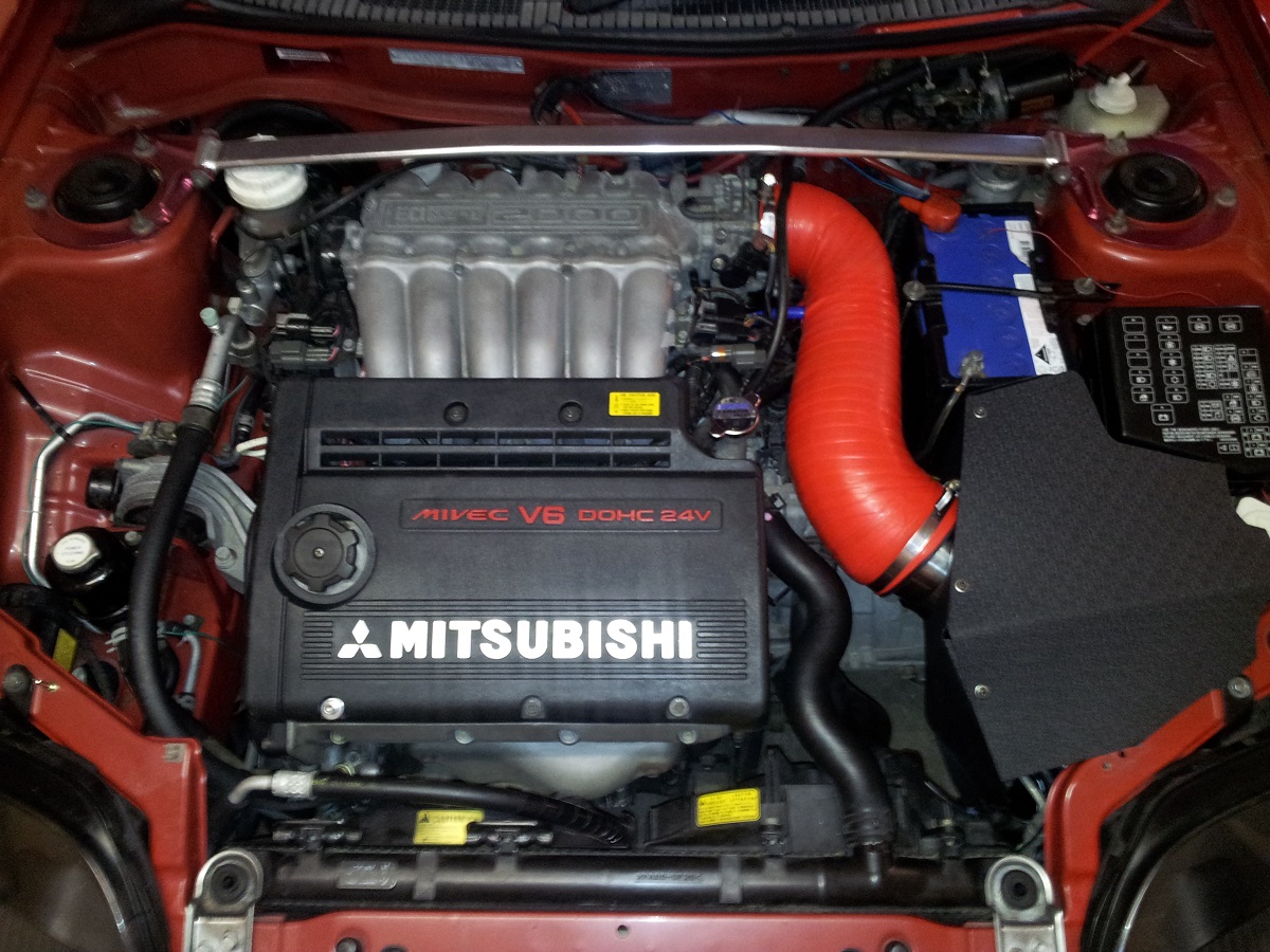

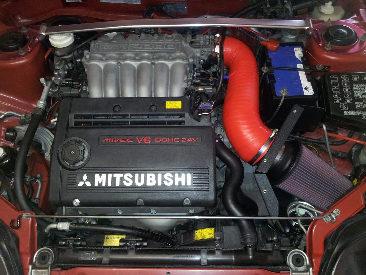

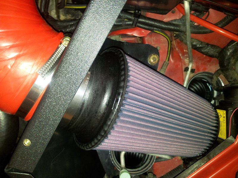

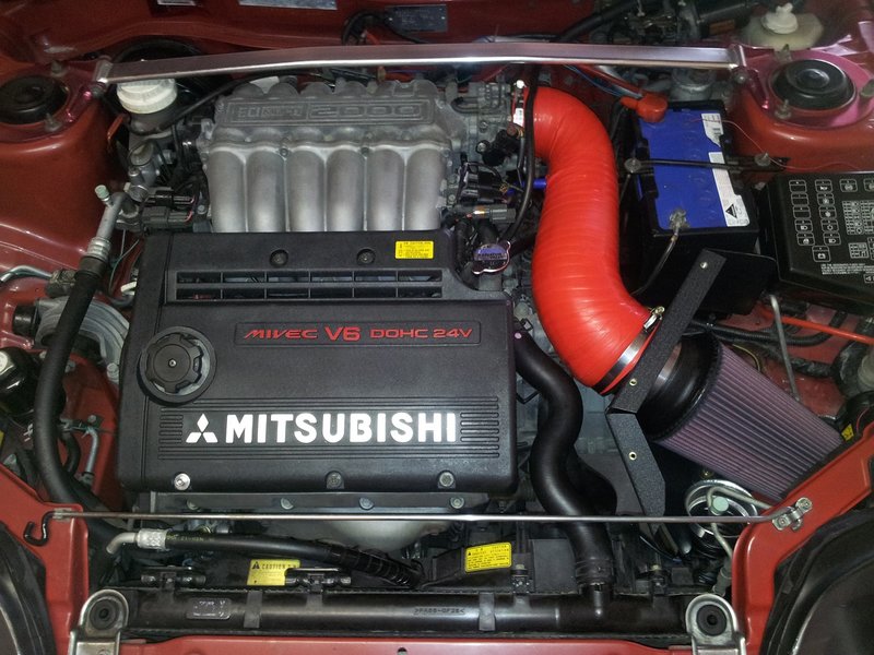

Here are the pics of mine.
You can't really see the stainless pipe in the first two photos, but it just attaches the filter to the intake pipe.
