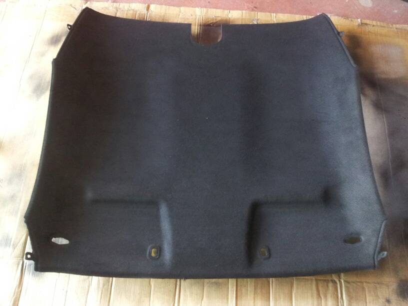

Just dyed a spare headliner I had.
Turned out pretty good, will take some photos after it's dried and in the car.
Posts: 9087
Re: Dying the Headliner
That came out sweet :D .
Looks awesome, I'd love to do this!

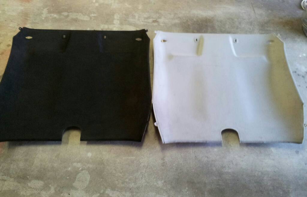

Nah, used VHT Vinyl Dye.
Comparison photo between the stock and black one.
Looks pretty cool, did you find much rust under there?
Posts: 3948
I took the headliner out a while ago and removed all the glue + rust.

Vectose wrote:Sure did, took me 3 days. :lol:
How many cans did you need as I'm planning on doing the same at some point after I've cut out and welded in new sections in the roof. :)
Posts: 3948
Used two cans.
