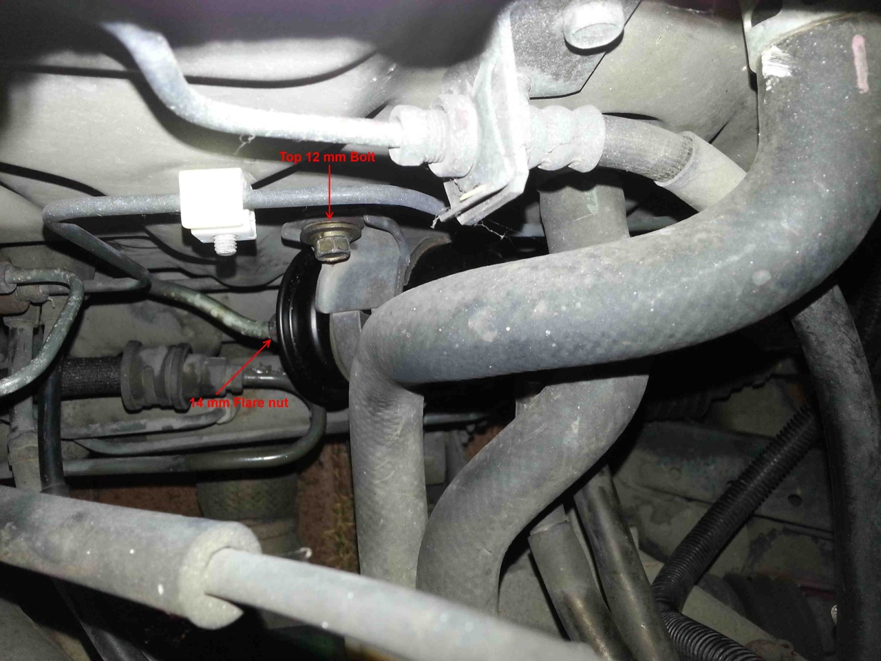

- Getting the 14 mm flare nut and the 19 mm banjo bolt off may require a fair bit of force.
- The fuel filter and lines will still have a bit of fuel in them so use paper towels or a rag or something to catch it as you loosen the nuts.
- When you bolt the new filter back onto the firewall, make sure the rigid metal fuel line (the one with the flare nut) is sitting in the filter.

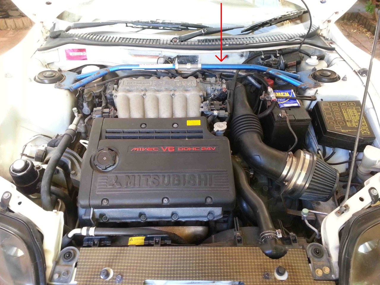

I took a couple of pics, just to help anybody who can't find the filter itself.
I used a Ryco Z441 fuel filter.
