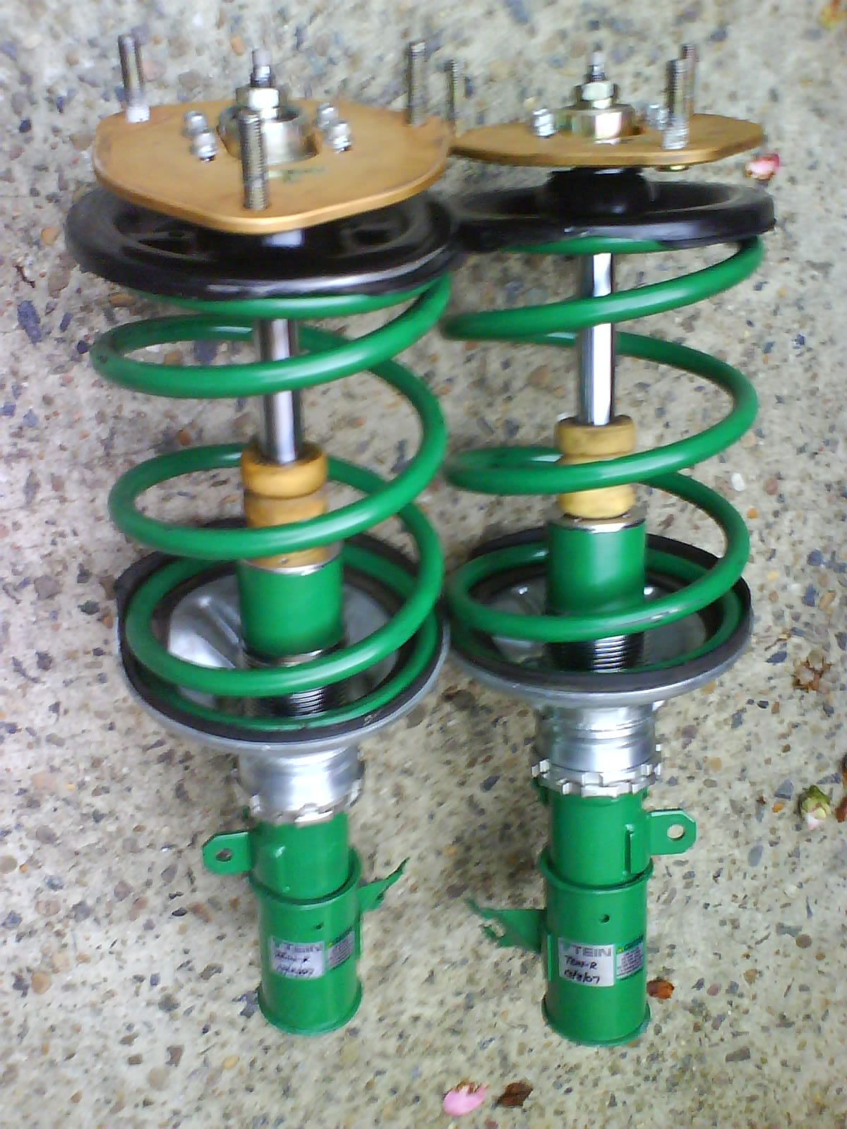

Problem is, that with standard diametre springs (although yours are Teins Phil) you can only get 1 - 1.5 degree neg camber MAX before the springs start rubbing on the underside of the towers & can actually bind up & get twisted / de-seated. It's happened to me on more than one occasion.

But having said that, yes they do firm up the ride a bit. Plus they fit on the Tein NAs.

How come you don't have those boots/gators?

    Bennoz how come you didn't install the gators on the shocks?
