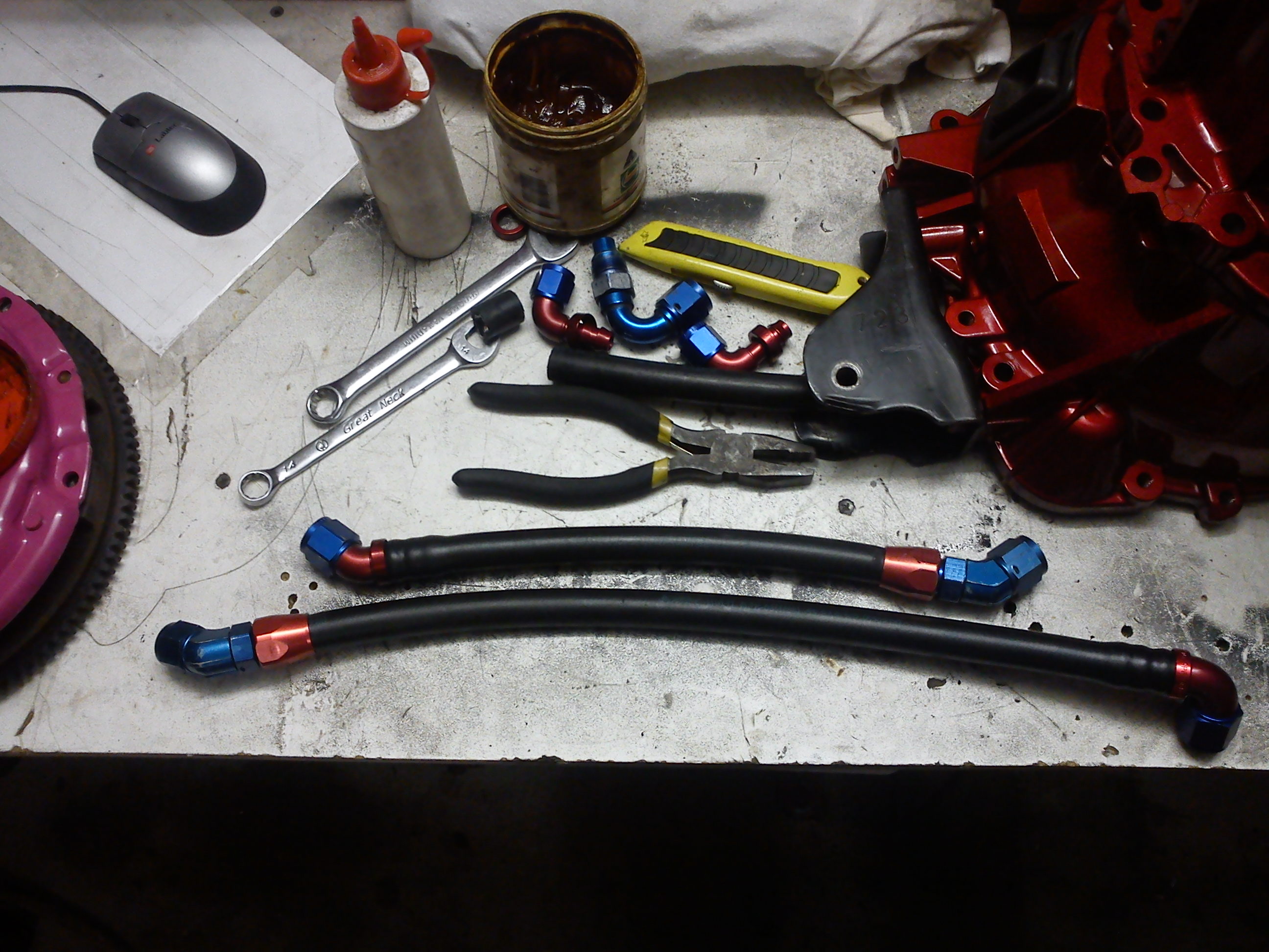

After much f**king around, got my fittings & some nice 500psi burst pipe from Pirtek & made up the lines

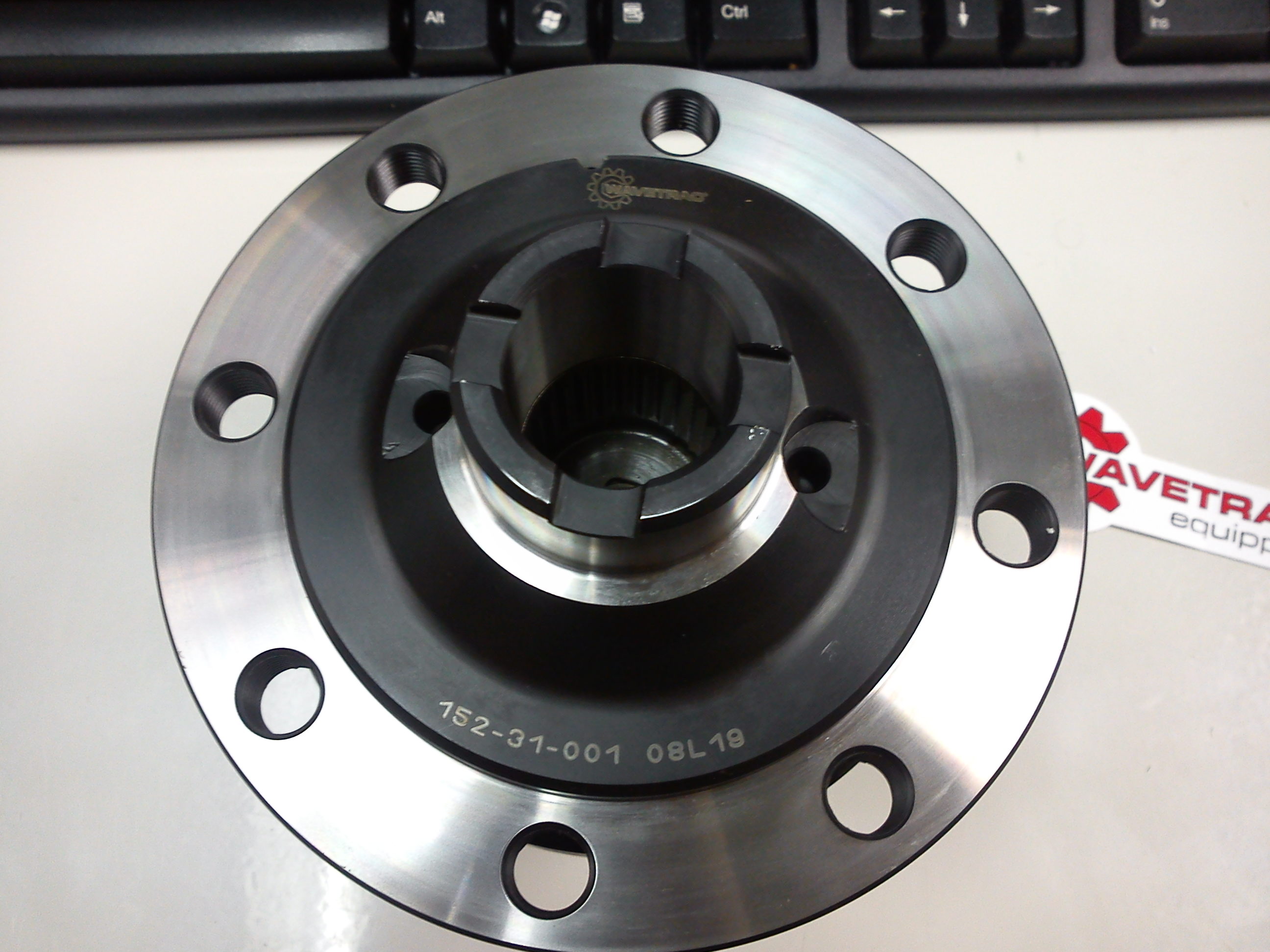

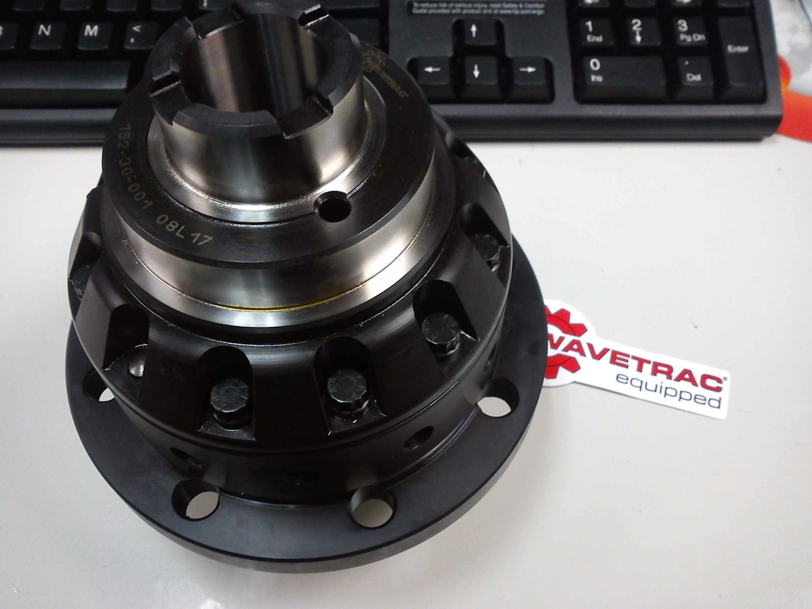

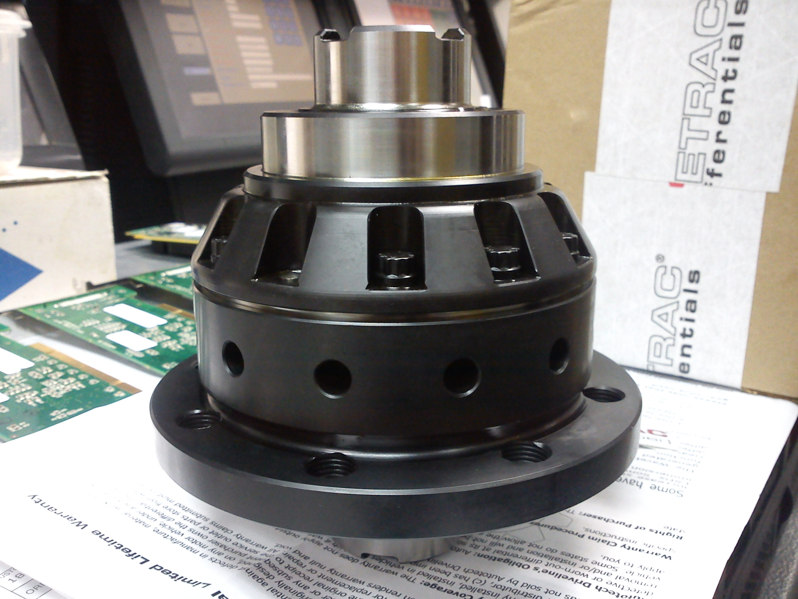

Re: Bennoz 6A13 Conversion
Its here and I might say its a rather impressively finished product. A nice peice of engineering. ARP fasteners through out... and 2 free stickers!
The only thing stopping me putting it in & going for a test run tonight, is if I run out of beer. Or shims lol, for the diff bearings.
