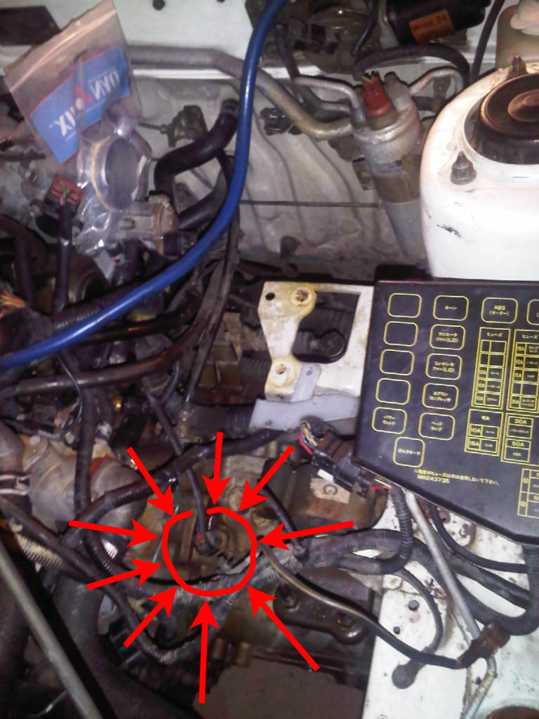

As ZFL45H1 said it is more than likely your switch, which is located on the top of the gearbox.
- Posts: 3947
Re: Fuse Box Translations
Before you buy a new switch, I would recommend taking it out and giving it a good clean with some throttle body cleaner or something similar. My reverse lights were not working before, so I removed the switch, gave it a good clean and they started working.

It is pretty easy just remove your air intake pipe and u sure pretty much be staring at it u just need a 22mm deep socket or around that size other then that it's easy good luck let us know how u go:DAqua wrote:Thanks for all the support guys!
I will try removing it (hopefully its easy? coz I've never done it before...) and cleaning it first...
- bass_twitch
- Posts: 2423
Reminds me, I need to do mine.ZFL45H1 wrote:It is pretty easy just remove your air intake pipe and you sure pretty much be staring at it you just need a 22mm deep socket or around that size other then that it's easy good luck let us know how you go:DAqua wrote:Thanks for all the support guys!
Anyone got pictures of it?
A picture courtesy of mikeey01nzl
I hope I have pointed it out clear enough
- bass_twitch
- Posts: 2423
Can't see itPHIL069 wrote:A picture courtesy of mikeey01nzl
Cool,
Thanks Phil
I'll do it eventually. Might check the no. 3 fuse first, just in case.

Good news guys! turn out the switch was disconnected! so i just plugged it back in and the reverse lights work now!
Thanks for the support and suggestion everyone!
