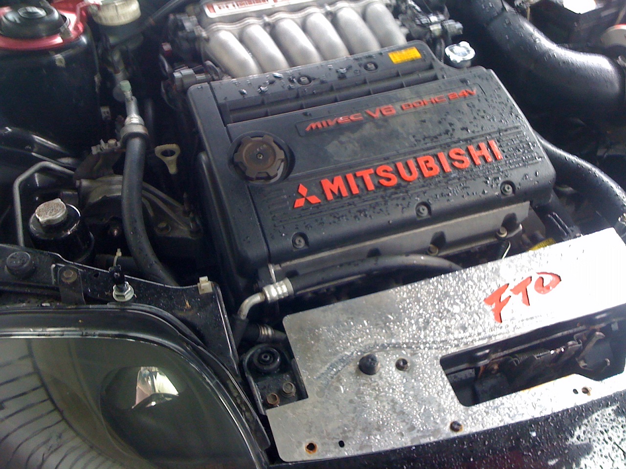

Since this is basically a thread for bragging about your UAS Pipe, I thought i'd do the same lol
Posts: 5518
Re: Uas kit installation
f**k wrong photo lol MEHHHHHHHHHHHHHHHHHHHHHHHHHH
Sahin wrote:Since this is basically a thread for bragging about your UAS Pipe, I thought i'd do the same lol
Thanks for showing off my awesome headlight polish work bro :P :lol:

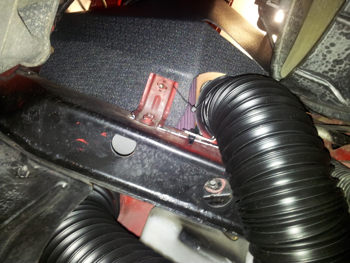

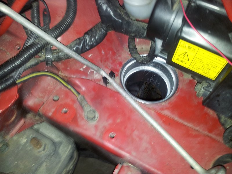

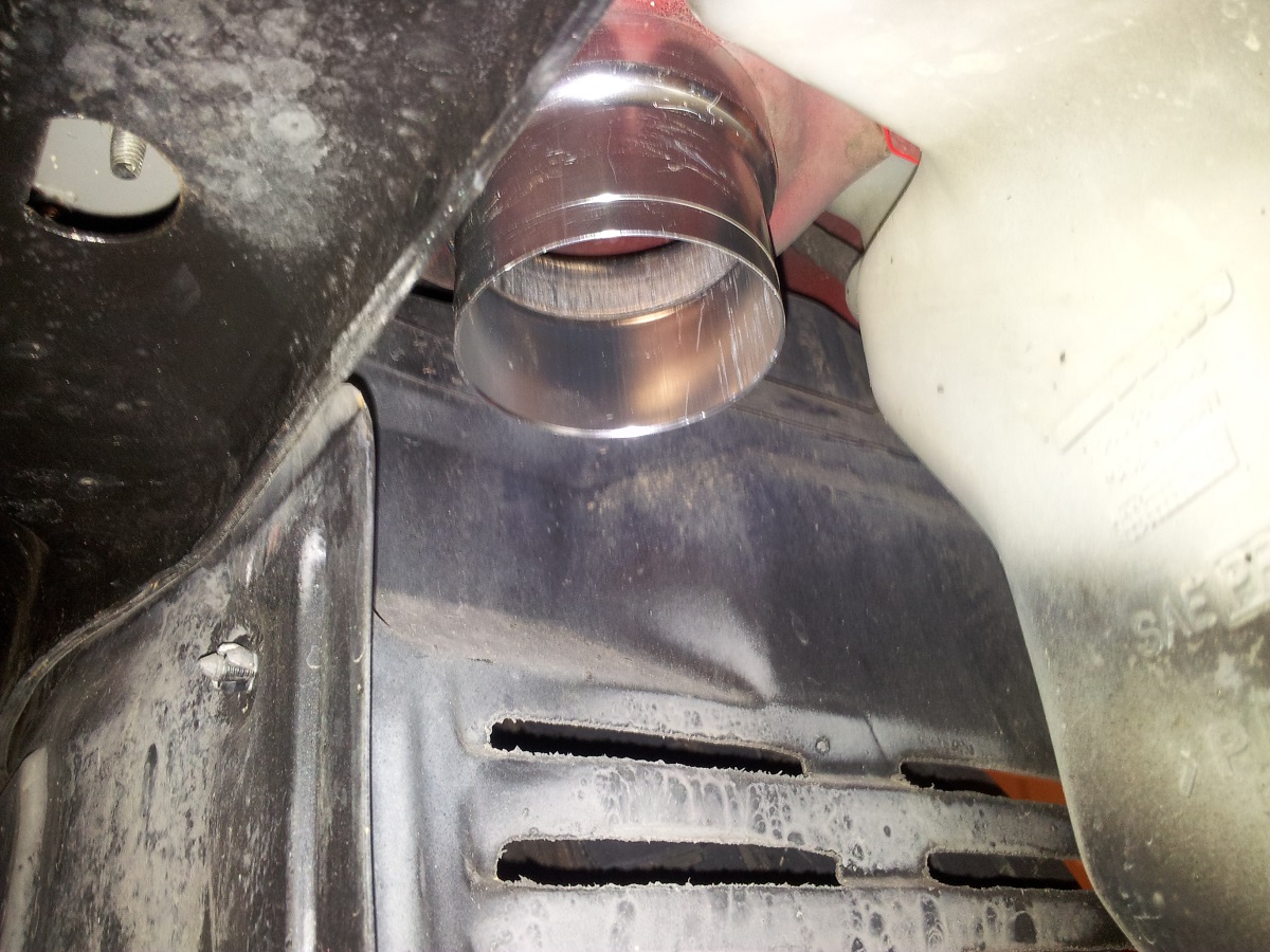

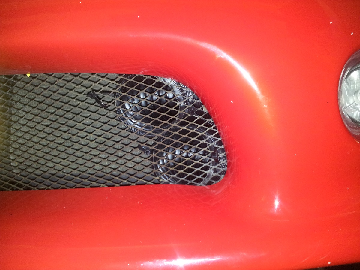

Here you go. I just got two flexi pipes from eBay and put one in the factory spot and one on the side of the chassis rail.

@Rob, thanks for the pics. Damn! another stainless steel attachment.....where do you get all those free stainless steel pipe attachments from? :\
Posts: 3947
Those aren't stainless. They're aluminium and came with the flexi pipes. They come with one on each end.

Did you have to mod the stock air inlet hole in the chassis? Where that aluminium bit is sitting nice and snug.
Also, was 1m enough length to reach from the front grill to the box/stock hole?
Posts: 3947
Nope, just removed the stock piping and the aluminium piece fits in from the top perfectly.
Then you just attach the flexi pipe from the bottom with the provided clamp.
Yes it was long enough, I bought the exact ones as I linked to.
